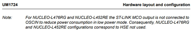

@SWenn.1 wrote:
this FW does NOT seem to run if I don't keep the usb connected to the nucleo?  Why is this?
In addition to the unpowered ST-Link holding NRST low, as @Sarra.S mentioned, note that the MCU clock source on most* Nucleo boards defaults to the ST-Link - have you taken that into account?
https://community.st.com/t5/stm32-mcus-boards-and-hardware/nucleo-f103rb-run-on-startup/m-p/687751/highlight/true#M19679
On the NRST thing:
https://community.st.com/t5/stm32-mcus-boards-and-hardware/external-powering-of-nucleo-l031k6-hsi-able-to-run/m-p/663084/highlight/true#M18423
EDIT:
* It seems that the Nucleo-L476RG is an exception:

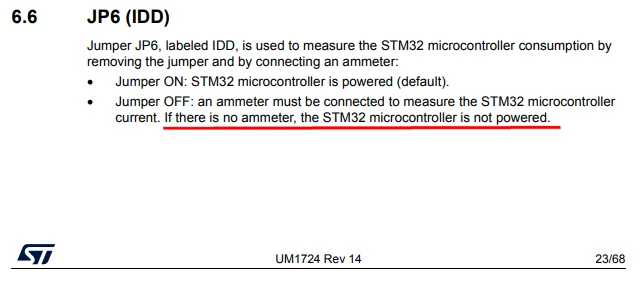

@SWenn.1 wrote:
I have removed JP6
JP6 is the Idd measuring link - when you remove that, you disconnect power from the Target MCU.
The idea is that you insert a current meter here to measure the Target MCU's current consumption:
