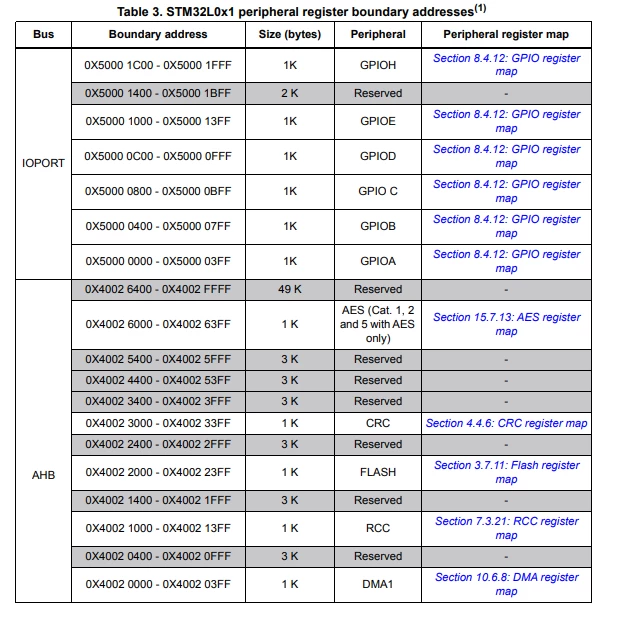

I am new by using nucleo board. I am evaluating the bootloader which runs fine for y first tests and I try to enlarge configuration capabilities. To focus on this goal I am looking for the registers map available with STM32L0 series.
In the reference Manuel are documented each peripherals with their registers through offset address, but not the reference address for each kind of peripheral. A description of those addresses will be welcome.

In the reference manual you can find the start address of each peripheral like in this table:

@butterfly  you'll also find them in the stm32l0xxxx.h header for your particular chip - which is probably more useful ...

Andrew, many thanks to answered me. Un stm32l0xxxx.h is surely the quickest way to got registers mapping, therefore this is software, include with softwares package. I am evaluating board from scratch ( that's means without Nucleo tools) and it's seem to me the configurations registers are in space address 0x1FF0 0000 - 0x1FF0 1FFF . Do you provide a way to document this space address?
