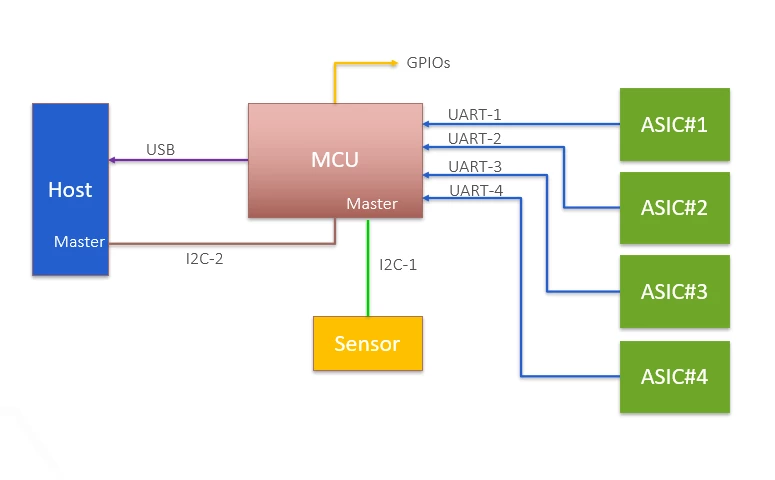

Looking for a suitable MCU for USB to 4 UART and I2C
Hi Sir,
I'd like to choose STM32F103V/R/Z to achieve the USB to 4UART and I2C in my system.
Because it's said this MCU's USB support up to 8 bidrectional end ports. I don't know whether it's right or not.
Could you help to review it or propose another suitable MCU? Thanks a lot.

What is the host on the picture?
If you want the UARTs of STM32 behave all independently as "virtual COM ports", and work with in-box Windows driver, you'll need 4 sets of endpoints for 4 CDC ACM interfaces. And some endpoints for I2C function, which does not have a "standard" driver in Windows.
If you can go for a custom software interface (winusb or libusb API), then all the functions can be handled with a few endpoints: maybe just 4: IN interrupt, IN bulk and OUT bulk and the EP0. STM32 program will multplex and buffer data for the bulk EPs.

August 28, 2024
You can consider the Host as a server which is to print the system log thru USB port. I2C is connecting Host's BMC. Yes, your understand is all right.
And how about STM32U575 which have 5 IN and 5 OUT EPs and EP0?

Bill_WAuthor
August 29, 2024
There're 4 ASIC's UART log independently output frequently.
August 28, 2024
Hi @Bill_W
Given the specifications from the datasheet, the STM32F103 series could be a suitable choice for your application for one single CDC not 4 CDC ACM interfaces. U575 provides greater flexibility embedding UCPD controller and is well-suited as well.
As @Pavel A. mentioned:
EP0 used for control requests
EP1 IN used to send notifications to host
EP2 IN used to send UART data from MCU to host
EP3 OUT used to receive UART data from host to MCU

waclawek.jan
August 28, 2024
As @Pavel A. said above, if you want somewhat "out of the box" solution, you'll go for the CDC ACM a.k.a. VCP; and as said in the thread @BarryWhit linked to above, for VCP  you essentially need 2 pairs of IN endpoints (one in/out pair plus one extra in endpoint). If you'd solve the I2C using VCP too, which is probably a sane expectation, that, plus the default/control EP0 pair is 5x2+1 = 11 endpoint pairs.
AFAIK no STM32 has this in one USB module (you could use two in some STM32, but that means two cables, too, or a hub chip, both somewhat cumbersome solutions); so you either go for some different solution - custom driver on host side and custom (your own) USB class/protocol, where you'd multiplex several or all UART/I2C data into one pair of endpoints - or use a different mcu which does that much endpoints natively. If host is something you design too, this may be a quite viable option.
BarryWhit
Lead
August 28, 2024
The endpoint math can be a bit confusing (I know, since I made such mistakes in that thread), so I suggest you read the thread carefully.
Bear in mind that the throughput of a VCP is unrelated to the serial baud rate you set (in that context, it's just a piece of metadata). The throughput depends instead on the USB interface (FS/HS) and software/CPU performance.
I don't have hard numbers for USB HS, but it's plausible that you could get at least several tens of Mbps over a single VCP channel using it (you should test this, if it matters to you).
If this meets your host application requirements, you could have an arbitrary number of interfaces on the MCU side, multiplexed over one VCP channel on the OS side, while still enjoying the convenience that comes from having a default OS driver available. The latter makes makes deployment and (arguably) development much easier.
If the aggregate bandwidth requirements for all your client devices are modest, you may not even require a USB HS interface (which limits your choice of parts, and is generally available only on pricier part numbers) .
For various reasons, I don't think new designs should pick the old STM32F103 - even if it could do the job.
