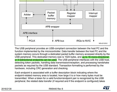

July 1, 2024
Indeed @gbm Sorry my bad @BarryWhit , 8 bidirectional endpoints.
Each unidirectional endpoint can be configured as IN or OUT (Means total 16 uni EP = 8 IN +8 OUT, including the control IN/OUT endpoint). Each of the 8 bidirectional endpoints can be configured either as control, interrupt, bulk or isochronous.

In  a single pair, there may be one in and one out endpoint, both of the same type. So three pairs may be used as bulk in+out for data traffic and three pairs  may be used for providing one interrupt in ep each. There will be one pair left but no extra int in will be possible, needed for the fourth CDC VCOM.
