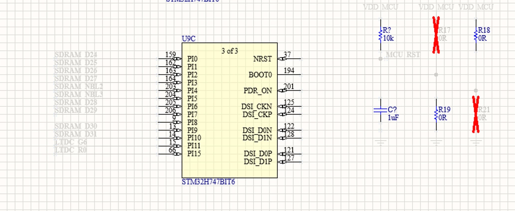

Find attached the schematics:

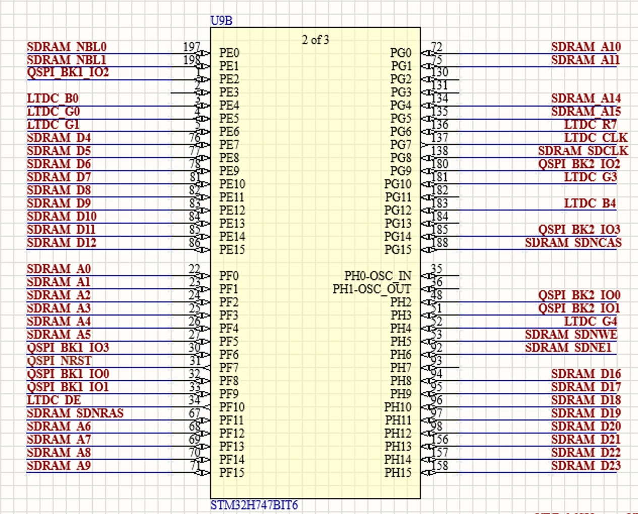

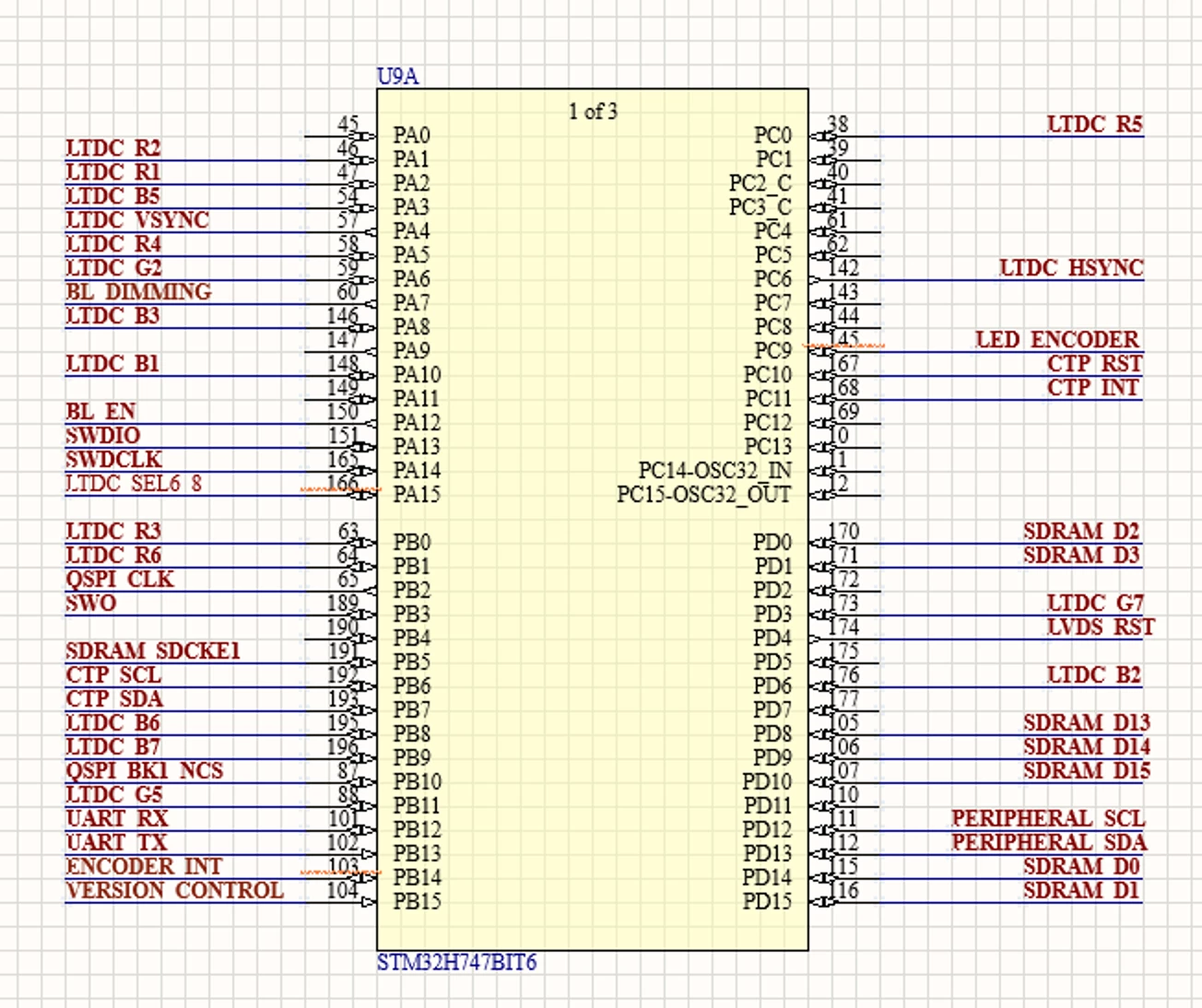

Please show all the MCU pin's (for example were are SWDIO / SWDCLK or the SMPS pins connected?).
The Power connecton is not what I'm expecting from a device with SMPS Power supply on chip. Please refer to the Reference Manual (RM0399) Capter 7.4 for Power connection possibilities.
p.s.: R17..R21 are 0R only two of them can be mounted, can you please tell us the mounted Resistors.
JonConesaAuthor
July 1, 2025
Apologies for the earlier incomplete information. Please find the updated connections to the MCU attached for your reference.
Regarding R17, R18, R19, and R21, only R18 and R19 are currently mounted.
MHoll.2
Senior III
July 1, 2025
OK, I have the following notes to Your schematic:
1) VDDLDO_1.. VDDLDO_3 should be connected together and supplied with a Voltage between 3.6V and 1.62V.
2) All three VCAP pins should be connected together (2 x 2.2uF is OK).
If the schematic is complete the main problem is the missing power on VDDLDO.
