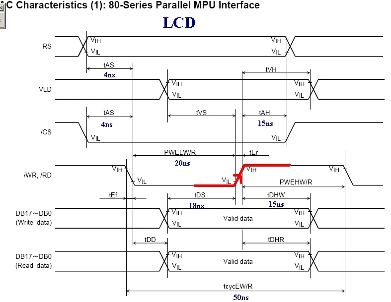

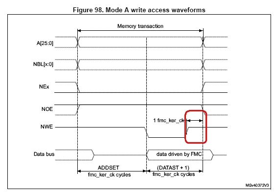

Hello, Everyone!
I found issue with using my LCD (via i8080 mode) with FMC. My display requires HOLD after DATA set from 15 ns time.
But in all FMC modes HOLD fixed and it 1 FMC CLK. For my STM32H743 at 400 MHz - I set FMC clock 200 MHz. It is HOLD = 5ns = 1 FMC CLK. And display works not properly.
1) I tryed reduce FMC clock down to 66 MHz, display working properly. Because HOLD after Data was set 15 ns and it is enougth.
2) I enetered FMC to NAND mode and set HOLD directly. Display works correctly too.
Any another solutions? How to insert more long Hold timing after Data setup in SRAM mode?
Attached pictures:
1) Timing diagrams for my display.
2) And FMC timing in SRAM mode (jnly 1 CLK HOLD)

    This is not H7-specific; this is how FSMC and FMC handle the static memories ever since, it has been discussed e.g. here https://community.st.com/s/question/0D50X00009XkZZNSA3/memory-with-long-write-recovery-time-with-fsmc-of-stm32f407ig . In some cases, not only data but also address need hold (or, in other words, the strobe signal - WR or CS - should end sooner); I know of no "regular" solution so far.

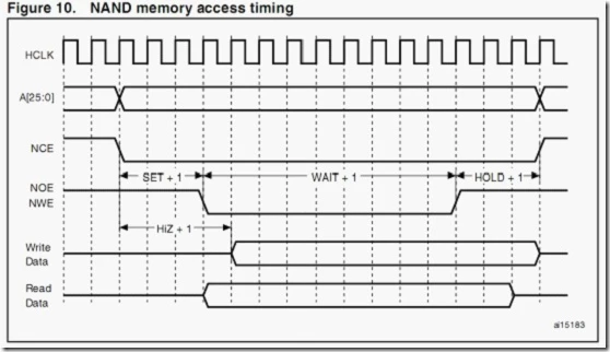

    I don't quite understand how NAND mode would help, but I did not study that mode in depth and it may be workaround. Karl, can you please discuss that in more detail?
    Karl Lipnen
    August 17, 2018
    waclawek.jan , FMC in NAND mode has the ability to set variable HOLD Time. See picture attached under this post.
    I successfully tested my LCD with this code:

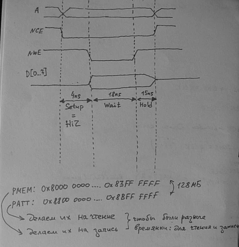

    LCD IO for write (fast timings):
    #define LCD_WR_COM16 (*(volatile unsigned short int*) 0x80000000)
    #define LCD_WR_DAT16 (*(volatile unsigned short int*) 0x80010000)
    LCD IO for read (slow timings):
    #define LCD_RD_COM16 (*(volatile unsigned short int*) 0x88000000)
    #define LCD_RD_DAT16 (*(volatile unsigned short int*) 0x88010000)
    Total speed in my case for LCD: 200MHz/(1+4+3)=25 MHz
    Connection LCD and FMC:
    D0..D7 - LCD D0..D7
    NWAIT - not used
    NOE - LCD !RD
    NWE - LCD !WE
    NCE - LCD !CS
    A16 - CLE - LCD !RS
    A17 - ALE - not used

    Karl Lipnen
    August 17, 2018
    Early, I wrote about it here (most full description + pictures): https://electronix.ru/forum/index.php?showtopic=148029
