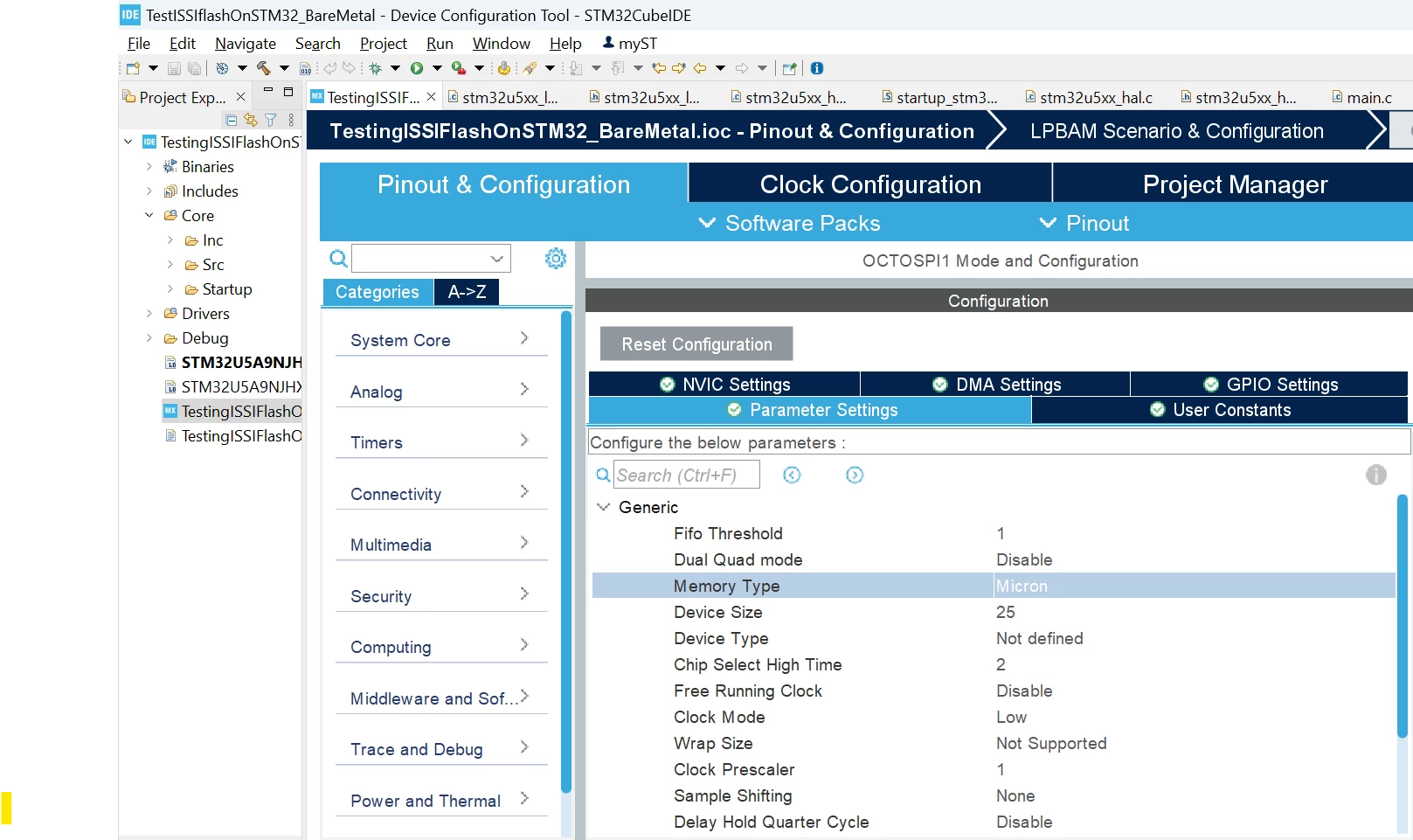

Hello STM Community,
I'm working on integrating an ISSI IS25WX256 flash memory with the STM32U5A9J-DK board. I've followed the configuration steps outlined in this [link] (https://community.st.com/t5/stm32-mcus/how-to-set-up-the-ospi-peripheral-to-interface-with-the/ta-p/49474) to set up the OSPI interface for the ISSI flash. Despite this, I’m encountering two main issues:
  1. Incorrect Device ID: When reading the flash device ID, I am not getting the expected values. Instead, I get incorrect data, often 0x00 .
  2. Timeouts in HAL_OSPI_Receive: Occasionally, the application gets stuck at OSPI_WaitFlagStateUntilTimeout within HAL_OSPI_Receive.
Here’s a screenshot of my OSPI configuration settings in STM32CubeMX (attach screenshot).

Any insights on what could be causing the incorrect Device ID readings or timeouts? I’d appreciate suggestions on additional settings or changes to the read sequence that may help resolve this issue.

We have built only one board so far. The same code was tested with the Macronix MX25UM51245GXDI00 flash, and we were able to read the device IDs successfully. Could you please confirm if my configuration for the ISSI IS25WX256 is correct, or if there is any specific sequence required in my code for(reading the device IDs) integrating ISSI flash with the STM32U5A9J-DK board that I might have missed?
Perhaps this is a hardware/electrical issue.
We probed the  clock and chip select, While getting stuck inside the HAL_OSPI_Receive during OSPI_WaitFlagStateUntilTimeout   the chip select is continuously low and clocks is seen as configured. It might be some configuration issue with the OSPI or the command configuration there is no activity on the data line DQ0.
Has anyone successfully used this combination (STM32U5A9J-DK + IS25WX256)? or any other STM32 + ISSI flash  Any additional suggestions would be highly appreciated!

Around here we'd probably mount a BGA24 ZIF on a NUCLEO-144 to test things.
Build more than one thing, etc.
If you just stick in 1-bit modes the memory devices should be predictable and consistent.
The Micron vs Macronix modes mostly relate to the DDR methods.
Perhaps the delays / clock edge settings
