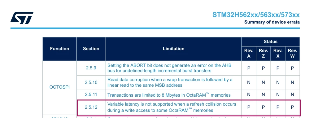

This matches errata ES0565 section 2.5.12 ("Variable latency is not supported when a
refresh collision occurs during a write access to some OctaRAM memories"). I applied the
documented workaround - forcing FIXED latency in the memory's configuration register -
and I run in the documented MTYP=0b011 (Macronix OctaRAM) mode. The corruption persists,
byte-for-byte identical, with the workaround correctly applied and verified by read-back.

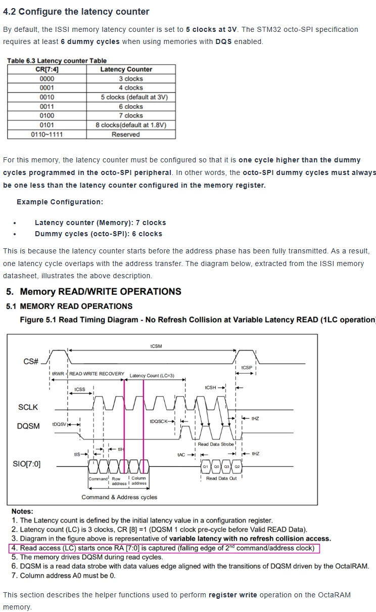

Device Configuration Register, read back from the IS66WVO:
  CR = 0xf12a
    CR[15]  = 1     normal operation (out of deep power down)
    CR[8]   = 1     DQSM read pre-cycle
    CR[7:4] = 0010  latency code = 5 clocks
    CR[3]   = 1     FIXED latency   <-- ES0565 2.5.12 workaround applied
    CR[1:0] = 10    32-byte burst length
Device ID register reads correctly: ID = 0x2c93 (manufacturer field = 0x3, ISSI).

Workaround: "When the application targets an OctaRAM memory that requests extra latency
cycles for write access during refresh collision, force the fixed latency mode in the
configuration register of the external memory."

Hello ​@sramrajkar and welcome to the community;
Could you please share the memory datasheet?
I recommend you to look at How to configure and use ISSI OctaRAM™ with STM32U5 over octo-SPI | Community article precisely section 4.2 Configure the latency counter.
According to the errata sheet this limitation is available on all silicon revision.
I recommend you to look at How to configure and use ISSI OctaRAM™ with STM32U5 over octo-SPI | Community article and get inspired to check your configuration. This technical guidance describes how to bring up and use ISSI IS66WVO32M8DBLL OctaRAM with STM32U5.
Note that the STM32U575 have the same erratum as the STM32H563.
I hope this help you.

Jun 27, 2026 2:57 PM UTC
Hi
Thanks — that confirms what I was seeing, and it's helpful to have it stated that ES0565 §2.5.12 applies to all STM32H563 silicon revisions.
I've since done a full characterization on two boards and wanted to report the results, plus one finding that is separate from the erratum and may be of interest to ST.
== Write path (the erratum) ==
I applied the documented workaround (force fixed latency, CR[3]=1 — device CR reads back 0xF14A, MTYP=0b011, confirmed on the wire) and also matched the STM32U5 OctaRAM reference configuration as closely as the H5 allows. Writes still corrupt. The behavior is now cleanly isolated:
- A write LANDS correctly: write a 32–256 B chunk, read it back immediately (uncached) — bit-perfect, every time.
- Data does NOT persist: after writing the rest of the array, a re-scan shows ~100% of previously-written words corrupted, including words that read back correct moments earlier.
So it is exactly the refresh-collision/disturb mechanism in the erratum: writing one region disrupts the device's hidden refresh of other rows. Things I verified have no effect on this: MTYP 0b010 vs 0b011, fixed-latency window 5→8 clk, st,csbound (0/5/8) and st,refresh, MaxTran, transaction sizes 4 B–1 MB, continuous vs wrapped burst write, ChipSelectHighTimeCycle up to max, mmap timeout counter, and pacing writes with idle gaps. Reads/register access/idle retention stay perfect throughout.
Could you confirm the intended usage model for OctaRAM *writes* on STM32H5 given this erratum? In practice it appears usable only as write-then-immediately-consume scratch or write-once/read-many, not as general read-write memory. If there is a register or timing recipe that makes sustained/scattered memory-mapped writes reliable on H5 (not U5), I'd be grateful for it.
