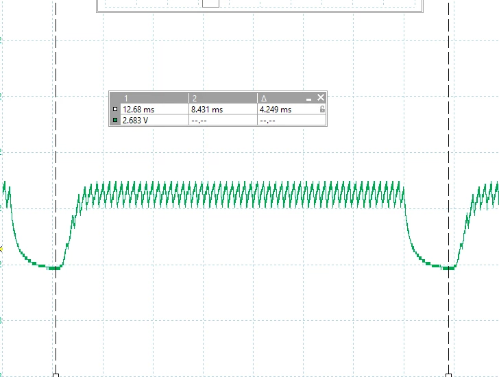

Is there a way to overcome "pausing" during DMA Circular transfer?
Hello I am using the STM32F334 for Lighting and I have had to use the DMA to transfer duty cycle data to the PWM duty register. The DMA is set up in circular mode and there is no interrupt. The priority it set to High. But i notice this pauses between the packets. I would have expected it to have no pauses. Please how can I get rid of this? Please see the image of actual light intensity. Hope to hear from you. thanks

Ok I will add the image. My switching frequency is 120kHz, so 8.33µs period, it will need to be off by 66. Here is the image. I also cannot upload more than 1 file.

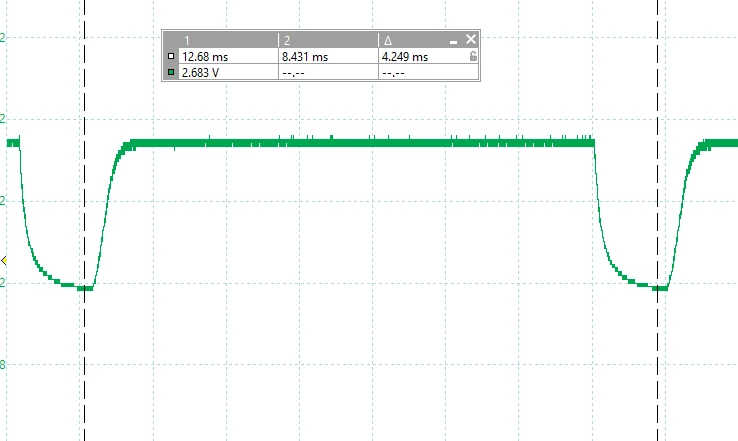

ambrose
ambroseAuthor
Oct 28, 2020 9:20 AM UTC
Another image

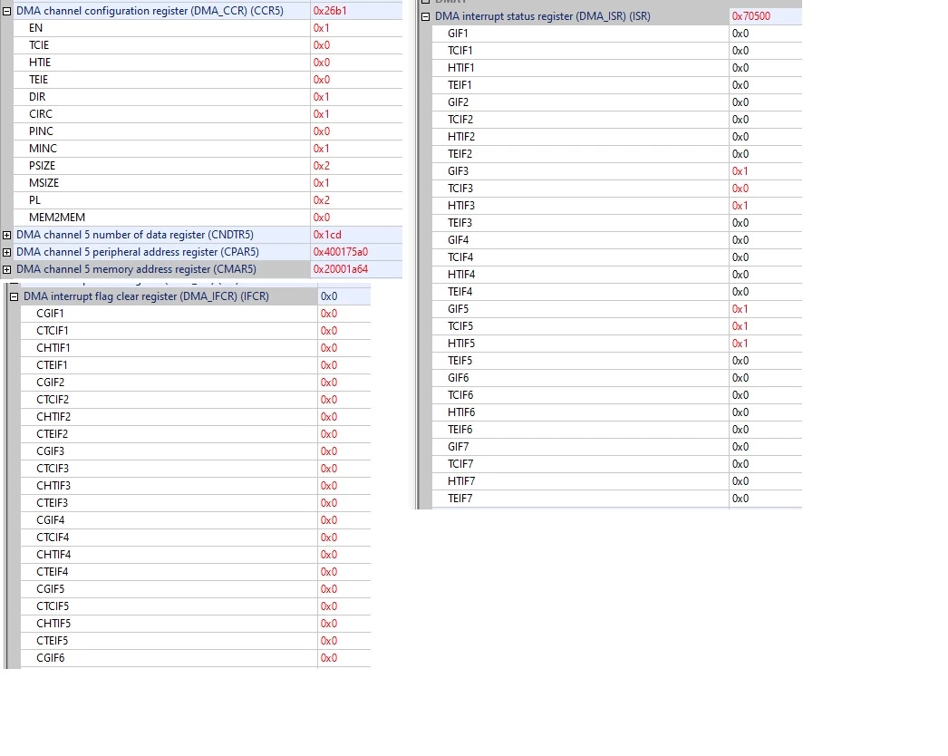

waclawek.jan
Oct 28, 2020 9:23 AM UTC
Read out and post content of relevant TIM and DMA registers.
Also read out and post content of relevant data array.

ambrose
ambroseAuthor
Oct 28, 2020 10:12 AM UTC
@Community member​  I have images below. @Community member​ I will do the test thanks everyone.
DMA Registers. I am using Channel 5

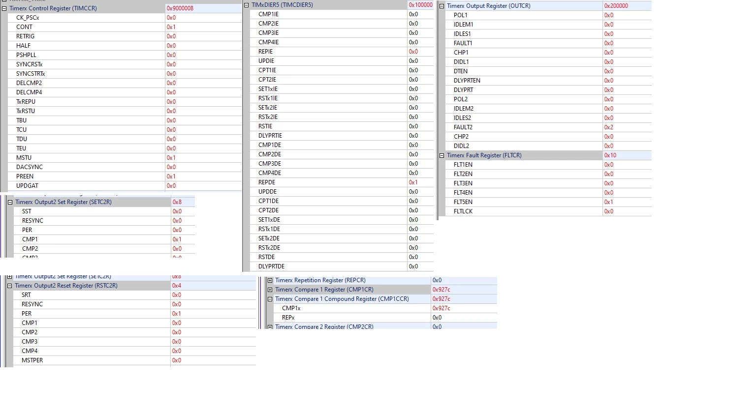

ambrose
ambroseAuthor
Oct 28, 2020 10:13 AM UTC
Timer register
ambrose
ambroseAuthor
Oct 28, 2020 10:16 AM UTC
Thanks i think there is an issue with the data.
ambrose
ambroseAuthor
Oct 28, 2020 10:44 AM UTC
@Uwe Bonnes​ You were right; It was off by 64. thanks
