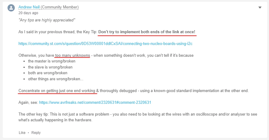

@Mpraj.19​ "i want to know can i connect both board with each other using expansion header ?"
This still leaves the question of what pins you want to use - UART? SPI? I2C? Other?
"I bought both board to learn about them practically."
I would strongly suggest that's not a great starting point - you are giving yourself too many unknows all at once!
This comes up frequently!
0693W00000QM3ETQA1.pnghttps://community.st.com/s/question/0D53W00001g0zuFSAQ/how-to-control-one-stm32-using-another-stm32-via-uartusart
https://community.st.com/s/question/0D53W00001dwYIASA2/i2c-master-transmit-and-slave-receive-functions-work-master-receive-and-slave-transmit-dont
It would be far better, I suggest, to:
  1. take just one of those boards, and learn to use its interfaces.
  2. then take the other, and learn to use its interfaces.
  3. finally, when you are competent with both boards, you will have the necessary skills & experience to connect them together.
Probably the easiest starting point would be to use the Arduino and its UART to communicate with a terminal on your PC.
