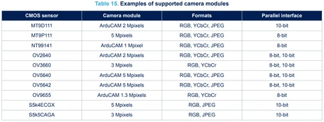

Hello @Ankur_1 ,
Same issue issue is reported here.
As I mentioned  "This interface is for use with black and white cameras, X24 and X5 cameras, and it is
assumed that all preprocessing such as resizing is performed in the camera module." sentence  should be removed from the datasheets to avoid any confusion with updated X24 cameras that can be found on internet. I reported this internally. In fact X5 and X24 cameras are referring to very old ST cameras.
AN5020 application note mentioned some CMOS sensors examples that are compatible with the STM32 DCMI.
