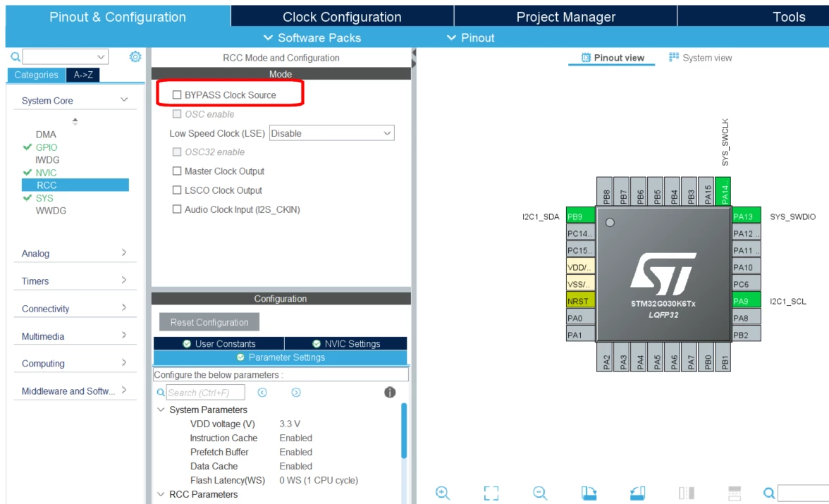

I am designing a PCB using the STM32G030K6Tx and for my application I only require the HSE external crystal, which I believe I connect to GPIO pins PC14 and PC15. When I go the the .ioc file in the STM32CubeIDE (System Core -> RCC) I see there is only an option to enable the LSE and no option to enable the HSE. How do I go able enabling the HSE? I have attached an image of the relevant section of the .ioc file.

There is no OSC_OUT pin on the 32-pin package, so you can't use a HSE crystal.
You can only use a HSE oscillator, ie. device which contains both the crystal and the oscillator and outputs the given frequency signal in itself, that connected to PC14, while enabling HSEON and setting HSEBYP in RCC_CR.

How would I implement this HSE oscillator in the .ioc file?
Andrew Neil
July 8, 2025
You'd need to use Bypass mode

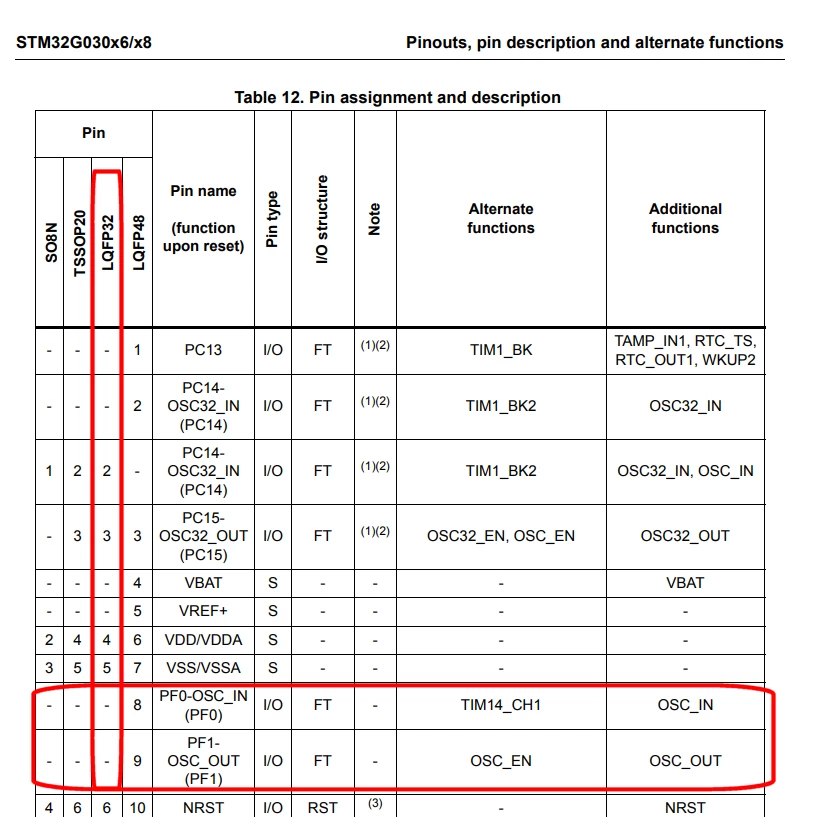

So the LQFP-32 package:

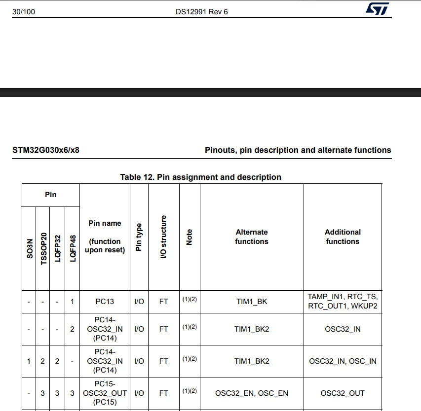

I think not - they are the OSC32 pins:
The OSC pins are on PF0 and PF1 - but not available in the LQFP-32 package?

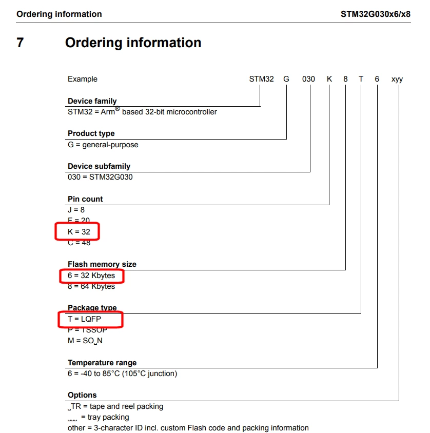

So should I use the 48 pin package? and what is its manufacturer product number?
Andrew Neil
July 8, 2025
If you want an internal oscillator, then yes.
But, as @waclawek.jan said, you can use an external oscillator - instead of just an external crystal.
PS:
See the Ordering Information - posted earlier.
