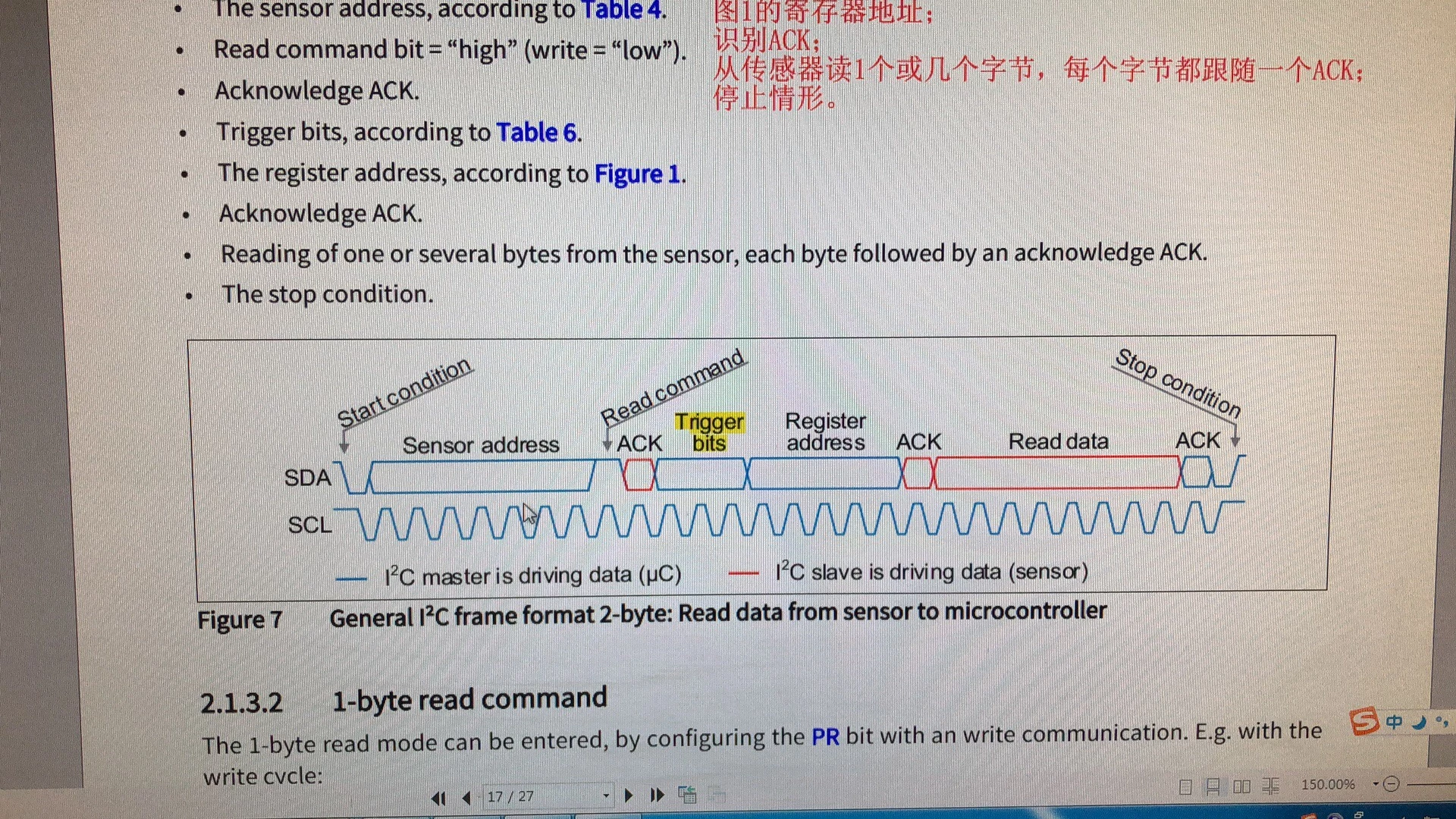

    0690X000006D8D0QAK.jpgHi,
    I'm using HAL_I2c_Mem_Read(), too.
    And may I ask if STM32's I2C can generate wave like the following picture. I have tryed Mem_read() and any other function in i2c.c , but the bit following device addres is "0",which means "write" in I2c.
    May you help me out, thanks.
    Tesla DeLorean
    Guru
    Jan 17, 2019 1:52 AM UTC
    Yes, that doesn't look like the usual I2C method, which is to have a WRITE with the Register Address, and then a READ which pulls the data.
    Probably going to need to bit-bang the frame here.
