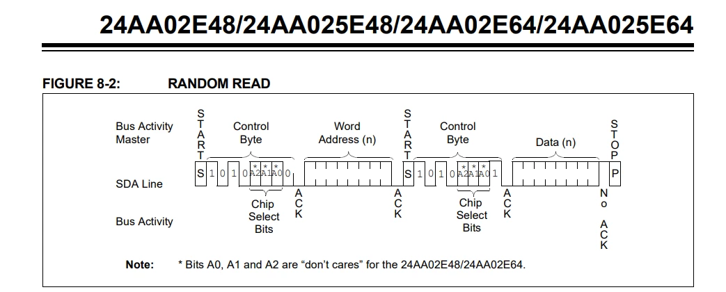

    S.Ma
    Principal
    Jun 7, 2023 5:58 AM UTC
    _legacyfs_online_stmicro_images_0693W00000dDHLSQA4.png24AA02E48/25E48/24AA02E64/25E64 Data Sheet (microchip.com)
    Notice the Restart bit in the middle? That is true I2C.
    It does not match your reference shared document.
    Same device, really?
