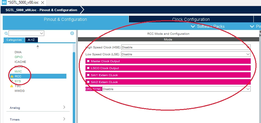

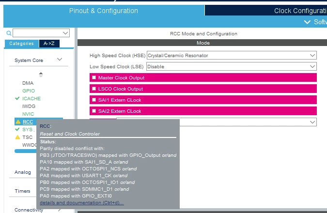

I would like to know how to configure RCC on my evaluation Board STM32L552E-EV.
I connect my I2C but when I connect an oscilloscope I have nothing on the clock signal. So probably I misconfigured my clock. Could you give me the information? Thanks in advance.
In this picture below I've a warning, do you know how to remove this warning please ?
0693W00000aI9LSQA0.pngThank you for your helps.

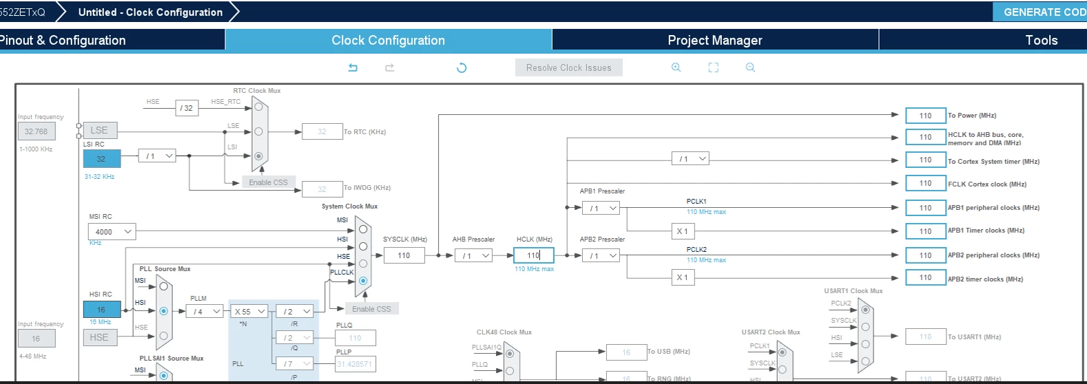

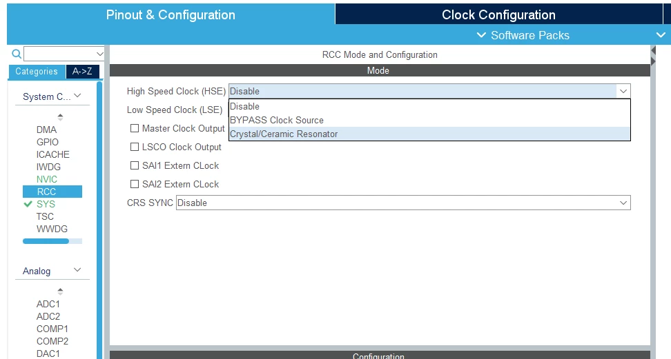

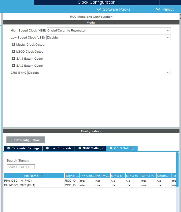

    For the clock configuration, you can manager your clock with the tab "Clock Configuration"
    0693W00000aIG9YQAW.pngYou have to choose your Source:
    • for the HSE source, please follow this step :
    0693W00000aIFp6QAG.pngIf you select the MCU selector, you will have all peripherals without default mode.
    Hope my answer helped you!
    Foued

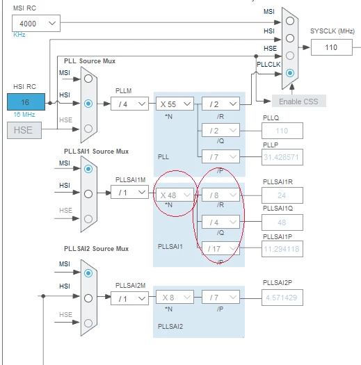

    Thank you for your helps, I have STM32L552E-EV evaluation Board and in your first screenshot I can't see the bottom of the screenshot, could you send me a complete copy of the screenshot please ? Why in the left of your picture all is green and for me I have the yellow color with exclamation marks, I'm afraid something is wrong that why I don't have the Clock of I2C. Normally it's automatic.
    Foued_KH
    March 6, 2023
    Please find the screenshot in the attached file.
    Foued

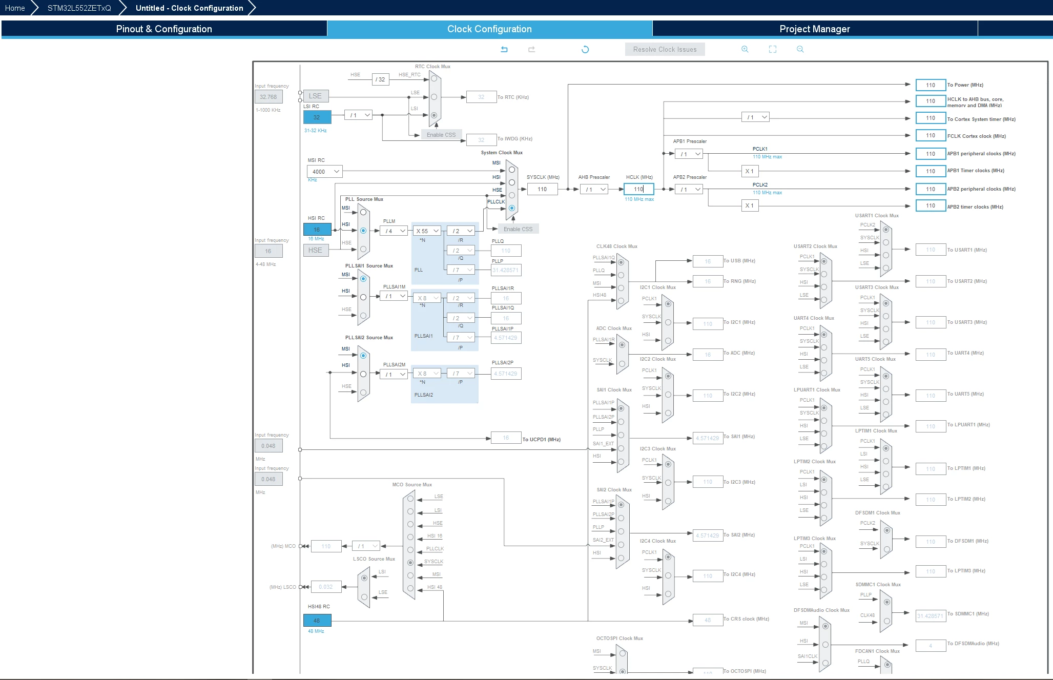

    Thank you but I can see only the picture above but I can't see the one below
    0693W00000aIHUSQA4.pngCan you please show me of the rest of the picture.
    Thank you
    Foued_KH
    March 6, 2023
    0693W00000aIHYtQAO.pngFoued

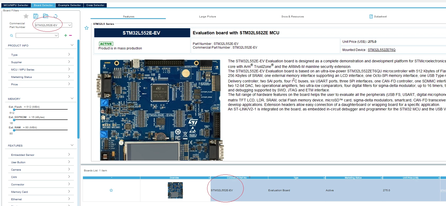

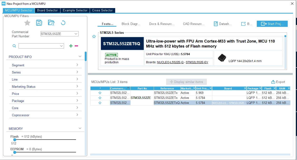

    Now with STM32cube i selected my evaluation board like this picture
    0693W00000aIH88QAG.pngI don't slected by default, because my configuration is probably not the same as default.
    0693W00000aIHtIQAW.pngI don't have the possibilty to do the same as your configuration.
    0693W00000aIHt8QAG.pngDo you also have the STM32L5 card? Or else it's not very important. And When I want to generate the code it shows me errors.
    0693W00000aIHlzQAG.pngDo you know where this error comes from ?

    Foued_KH
    March 6, 2023

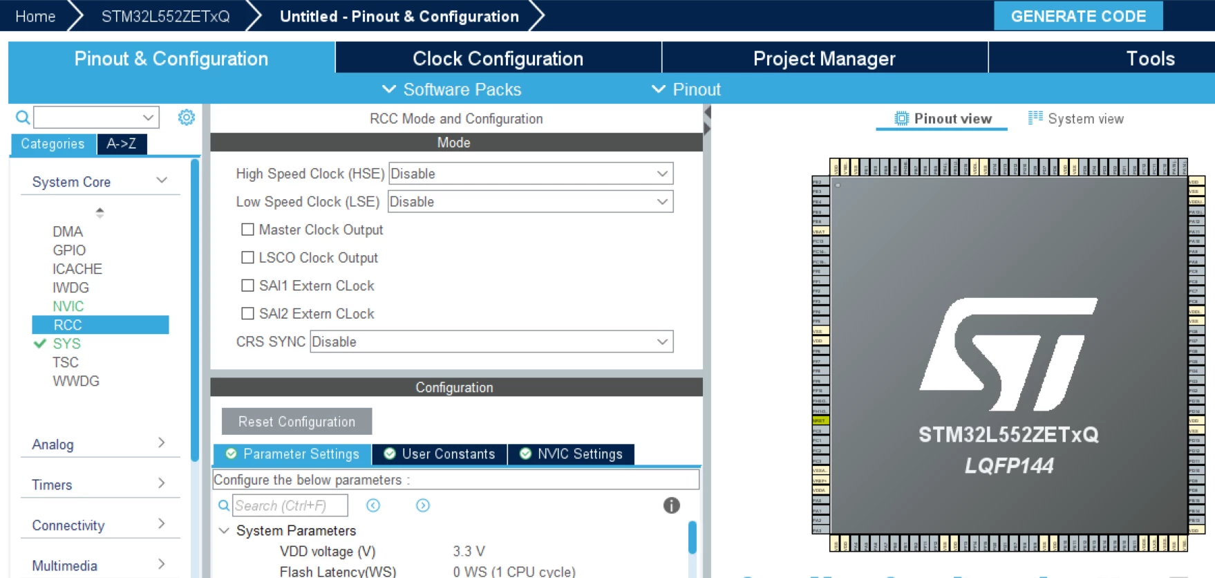

    I f you try with MCU selector and select the STM32L552ZE MCU:
    0693W00000aIHxuQAG.pngFoued

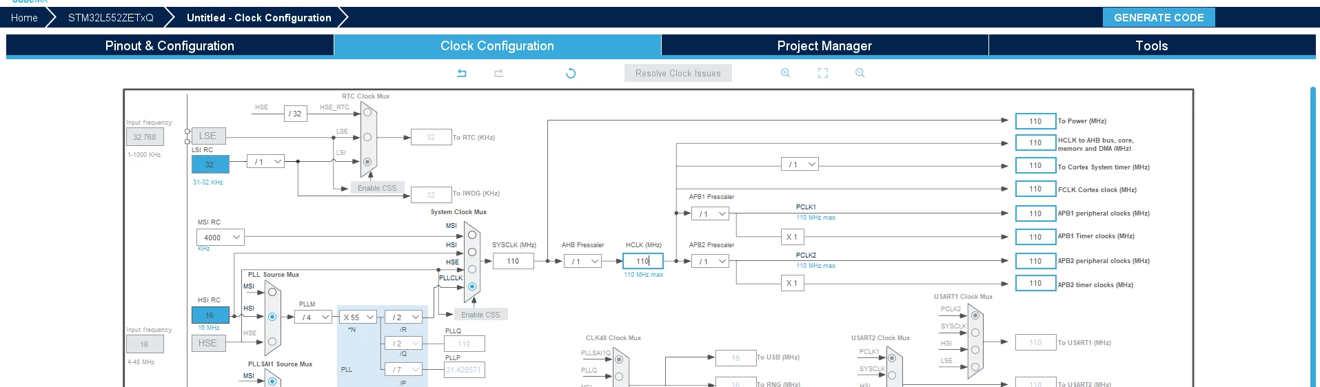

    I come back again, after having listened to your advice, I do not encounter any warnings or errors.
    0693W00000aILo2QAG.png 0693W00000aILnnQAG.pngAfter, this step how can I check if my clock is running correctly on my evaluation board? For example, can I test the HAL delay function ?
    I just to check this step before continuing to configure the I2C and then SAI.

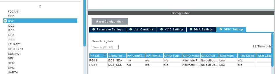

    I also configure I2C and no warning and no errors.

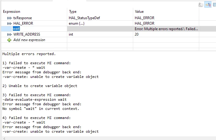

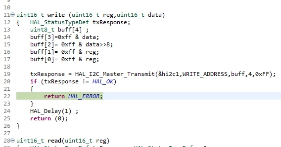

    After configuring the RCC, I2C and SAI I still have an error at the I2C level
    0693W00000aIMVuQAO.pngSomething is wrong but I don't know where it could come from
    Foued_KH
    March 7, 2023
    Transmits in master mode an amount of data in blocking mode:
    HAL_I2C_Master_Transmit(I2C_HandleTypeDef *hi2c, uint16_t DevAddress, uint8_t *pData, uint16_t Size,uint32_t Timeout)
    • hi2c Pointer to a I2C_HandleTypeDef structure that contains the configuration information for the specified I2C.
    • DevAddress Target device address: The device 7 bits address value in datasheet must be shifted to the left before calling the interface
    • pData Pointer to data buffer
    • Size Amount of data to be sent
    • Timeout Timeout duration
