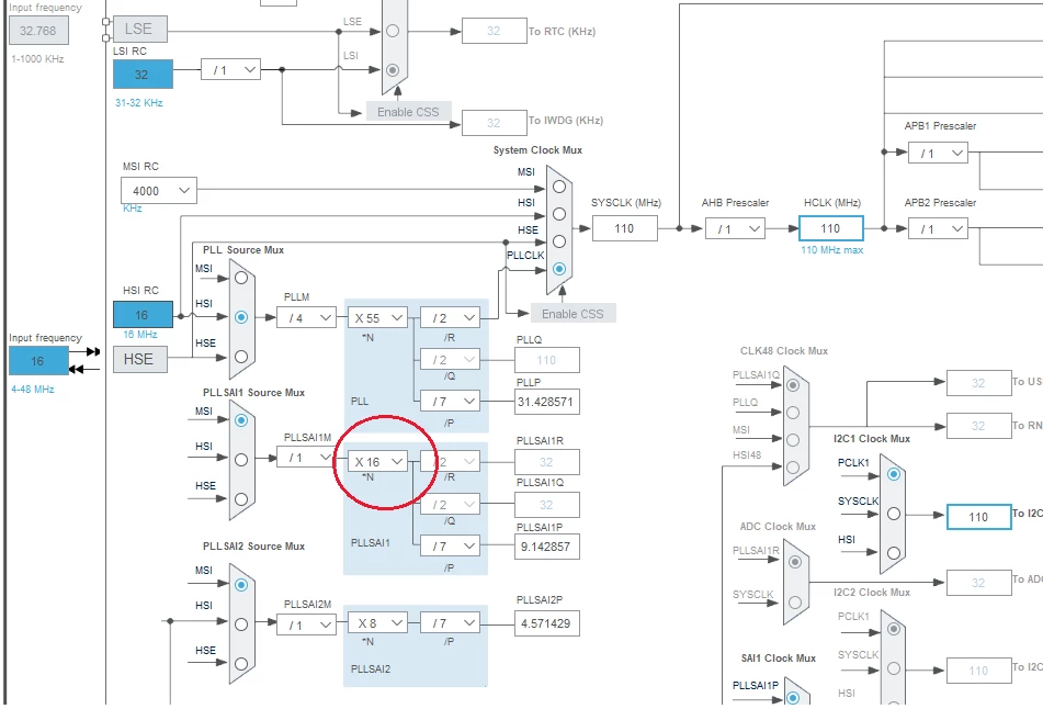

I would like to know how to configure RCC on my evaluation Board STM32L552E-EV.
I connect my I2C but when I connect an oscilloscope I have nothing on the clock signal. So probably I misconfigured my clock. Could you give me the information? Thanks in advance.
In this picture below I've a warning, do you know how to remove this warning please ?

    For the clock configuration, you can manager your clock with the tab "Clock Configuration"
    0693W00000aIG9YQAW.pngYou have to choose your Source:
    • for the HSE source, please follow this step :
    0693W00000aIFp6QAG.pngIf you select the MCU selector, you will have all peripherals without default mode.

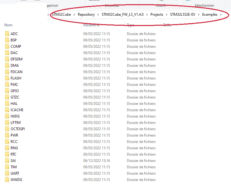

    All is correct after me. Do you have a working example for me to check the I2C communication ?
    Foued_KH
    March 7, 2023

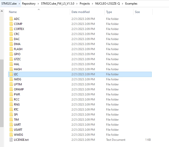

    You can refer to the I2C WIKI : Getting started with I2C - stm32mcu
    Also  you can refer to the CubeFW to find the I2C examples : STM32Cube\Repository\STM32Cube_FW_L5_V1.4.0\Projects\

    I know what i's I2C and how does it work. Someting tells me this is the evaluation board clock configuration. The I2C clock is a derivative of the main clock, that why in my previous message I would like to test the function Delay.
    I'll see the example but after me it does not exist on this evaluation board, let me check this information.

    That confirm my thoughts :

    You can use this I2C example. It's the same STM32L5 family and not tied to a specific development board.

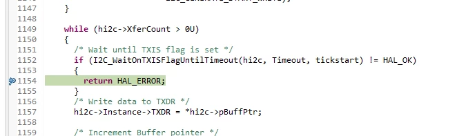

    I can locate the error inside the function
    0693W00000aINIiQAO.pngAnd the error is that this point
    0693W00000aINKsQAO.pngI don't know the signification of this error. Do you have any idea ?

    It's very strange when I come back to the '.ioc' I have a error and I selected resolve the error automatically. Now I have this configuration :
    0693W00000aINGsQAO.pngNormally the value is 8 but now it's 16. So I cant try again.

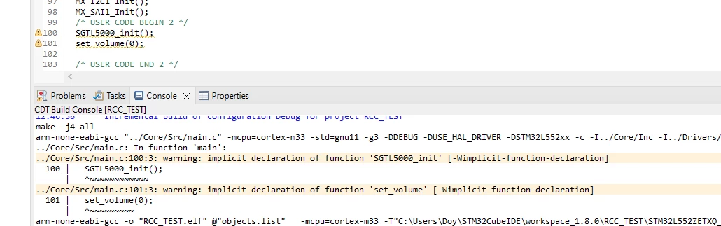

    I have a warning :
    0693W00000aINNhQAO.pngImplicit declaration what does it means ?
    But it's not very important, I can working. Now I have the clock on the SCL (just to have pull-up inside no pull-up).
    But I have always the same error

    Did you add the prototypes?

    Yes I have developed prototypes but the error comes from SysTick as I sent you an email. How to configure the SysTick with my evaluation Board STM32L552E-EV ? Just to check if my board still works.

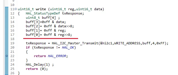

    Sorry I have another error :
    0693W00000aINBmQAO.pngbuff[0] had to make a shift. But I have always the same error.

    Explain your error.

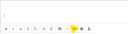

    And use the code snippet icon to add code instead of images. Makes it easier to copy code.
