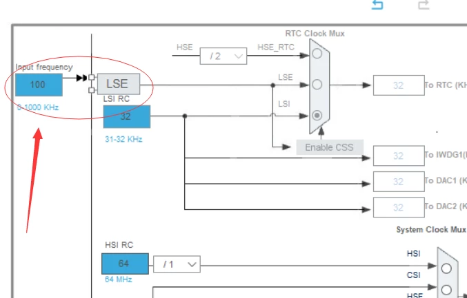

I use 100Khz oscillator for LSE on STM32H7B0VBT6 but LSERDY cannot work
100khz Oscillator for LSE input. The OSCillator works right bcz I test the waveform by scope.
but stm32h7b0vb cannot get lserdy bit set.
Seems I m the 1st Person meet the situation.
plz help me. Thanks.

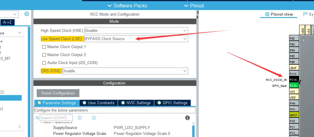

it is sure Oscillator , Not crystal. I set the bypass
I guess it is bcz ST not test LSE by freq other than 32768hz.
I also try​ call the function LL_RCC_LSE_SelectDigitalClock() but no effect

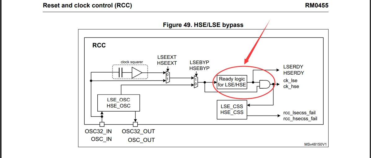

The primary purpose of LSERDY is to make sure the crystal starts to oscillate before proceeding with setting up other things. If you are sure your external oscillator is oscillating, you can simply avoid testing LSERDY.

but things are not that simple. Look at the pic below. I will explain it.
the "ready logic" module inside the red circle is very important, bcz follow it there is an "AND" gate, while the "ready logic" or "LSERDY Bit" output 0 then we will get CKLSE out always 0.
so we cannot ignore the Ready bit.

I fix the problem. THANKS
the Reason is I must call LL_RCC_SelectDigitalClock after EnableBypass.
now work well.​
