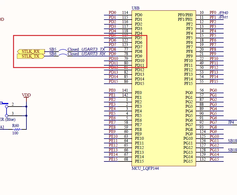

I'm using stm32f207ztg6 and want to do printf using UART, but it doesn't show up in Tera Term.
How can I solve this problem?

When HAL_UART_Transmit is executed, HAL_OK is returned, but nothing is displayed in "Tera Term".

Hello @t-oka ,
First, before starting the printf usage over UART, you need to validate the UART transmission by for example just sending a couple of characters using HAL_UART_Transmit().
Second, you need always to check the schematics or board's user manual before suspecting an issue in the FW.
According to the schematics of MB1137 the UART instance connected to STLink-VCP on NUCLEO-F207ZG (MB1137) is USART3 and not USART2:
So you need to select USART3 instead of USART2
Refer to this printf example. on NUCLEO-F207
Hope it helps.

Before adding the complications of printf, have you got this working by just doing the HAL_UART_Transmit direct?
If that doesn't work then, clearly, printf is never going to work!
Also note that stdout is line-buffered - ie, the output won't appear until you send a newline...
