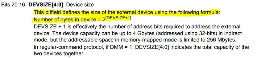

  3. The CubeMX generates template code that sets the value of 'DEVSIZE' in HSPI DCR1 to 26 for this design kit board that includes a 64MB HSPI PSRAM.
    *** BUT ***
    The note in RM0456 for HSPI DCR1 says that the size of the external memory address is calculated and expected to be 2^(DEVSIZE+1). If DEVSIZE is 26 then this would evaluate to 128MB.
    CLEARLY SOMETHING IS NOT CONSISTENT -- who should I now believe -- the CubeMX or the folks that wrote up RM0456?

3- The Device Size configured in STM32Cube MX indicates the size of the OSPI memory in bytes and expressed in 2^n.
How to configure "Device Size" in STM32CubeMX is descripted in How to set up the OSPI peripheral to interface with the IS25LX256 from ISSI and in table Table 7. STM32CubeMX - Configuration of OCTOSPI parameters in AN5050.
 The device size configuration is down in the HAL_XSPI_Init function by using this code
 /* Configure memory type, device size, chip select high time, free running clock, clock mode */
 MODIFY_REG(hxspi->Instance->DCR1,
 (XSPI_DCR1_MTYP | XSPI_DCR1_DEVSIZE | XSPI_DCR1_CSHT | XSPI_DCR1_FRCK | XSPI_DCR1_CKMODE),
 (hxspi->Init.MemoryType | ((hxspi->Init.MemorySize) << XSPI_DCR1_DEVSIZE_Pos) |
 ((hxspi->Init.ChipSelectHighTimeCycle - 1U) << XSPI_DCR1_CSHT_Pos) | hxspi->Init.ClockMode));
So, the DEVSIZE bits filed in XSPI_DCR1 registers get the Init.DeviceSize (configured in ioc file) - 1U, which is in line with RM0456 description.
In conclusion the "Device Size" in STM32cubeMX  is DCR1_DEVSIZE+1.

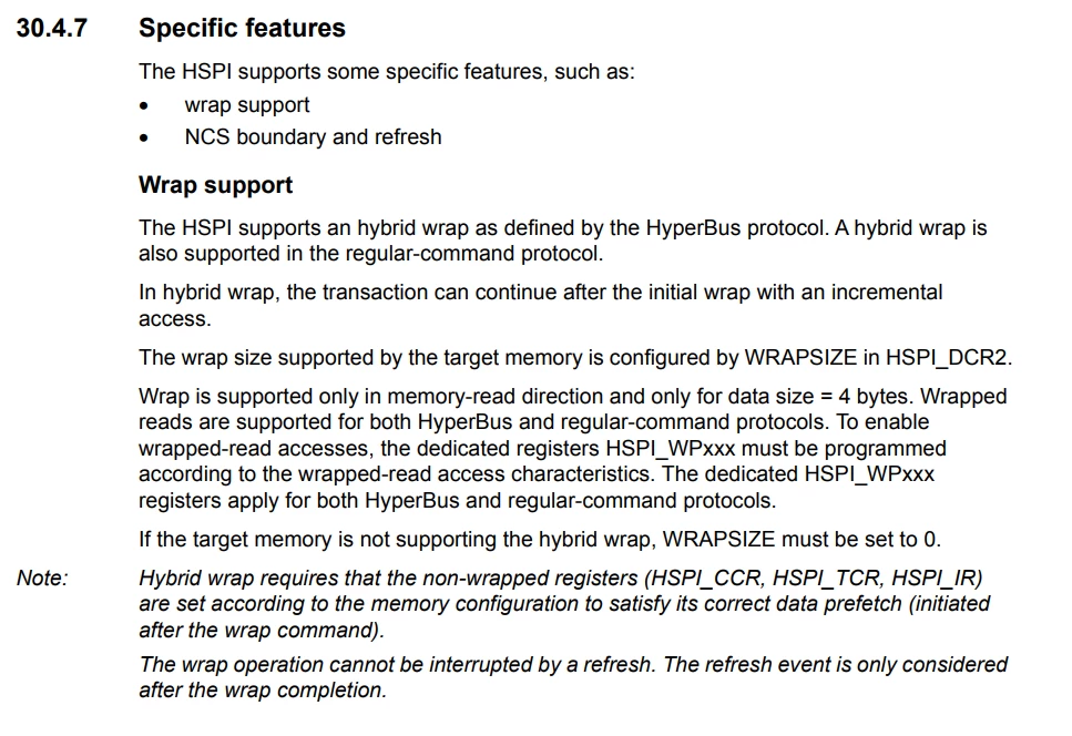

4- The HSPI support the wrap feature as described in RM0456.
Thank you.

Regarding question 3, I believe I incorrectly interpreted the output code and it is in fact correct.

YES, I am aware that HSPI does support hybrid mode. But I am curious as to why the HAL 'ignores bursts that are not HYBYRID'. This implies that the application MUST ALWAYS program the HSPI in hybrid mode.
Cheers

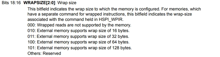

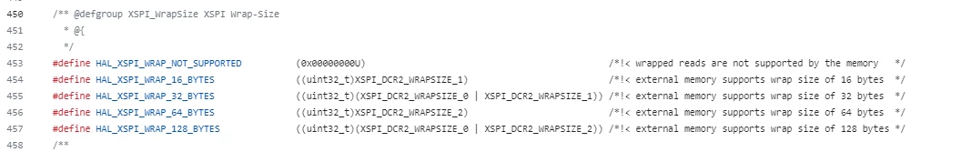

About the question 4: The HSPI supports an hybrid wrap and the wrap size is supported by configured WRAPSIZE in HSPI_DCR2:
This configuration is described in the stm32u5xx_hal_xspi.h Hal drivers:
Thanks and best regards,
Kaouthar

I am not sure how many more times I have to ask you the same question:
Why is the application being FORCED TO USE THE HYBRID mode in HSPI?
The way it is set up now, if the application choses NOT TO USE HYBRID MODE then this HAL driver DOES NOT GET THE JOB DONE AND CANNOT BE USED.

4- I am also noticing that the driver ignores bursts that are NOT HYBRID and sets up the HAL RAM configuration as 'HAL_XSPI_WRAP_NOT_SUPPORTED'.  Should I understand this as saying that the HSPI does not work well in non-hybrid wrap modes?
The HSPI interface supports the non-hybrid wrap mode.
This particular case is used when the external memory device does not support hybrid wrap mode.
The HAL drivers doesn't support directly the non-hybrid mode.
So, to configure this mode, you needs to set:
- The HAL configuration as 'HAL_XSPI_WRAP_NOT_SUPPORTED'
- The appropriate configuration parameters in the HSPI registers and configure the command.
I hope this answer your request.
