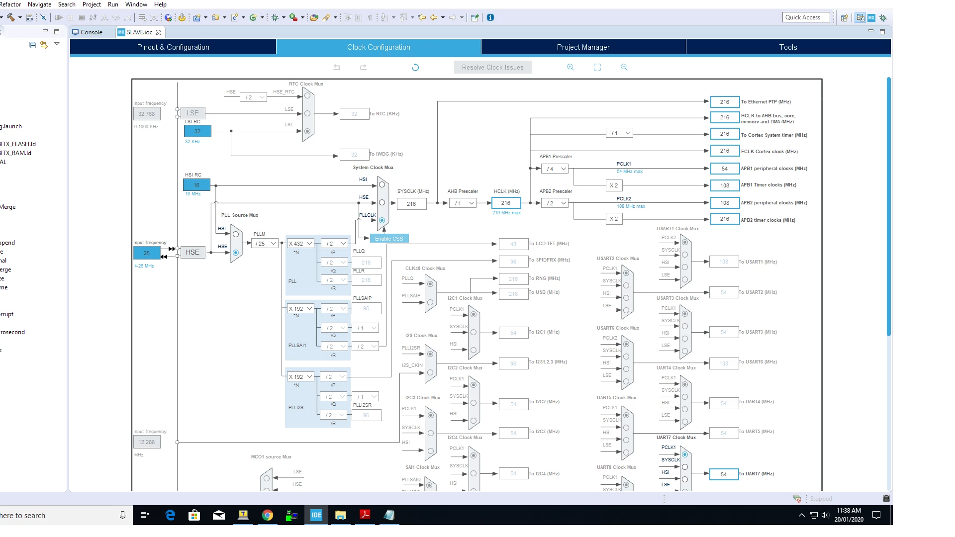

I am attaching you my clock configuration with this post

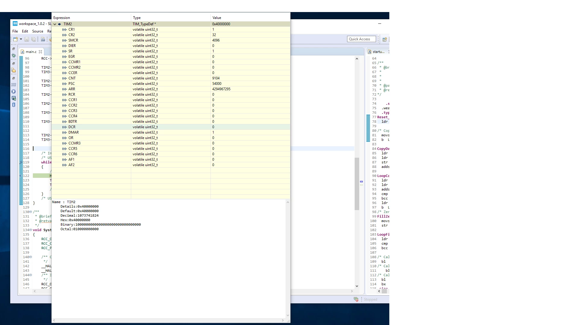

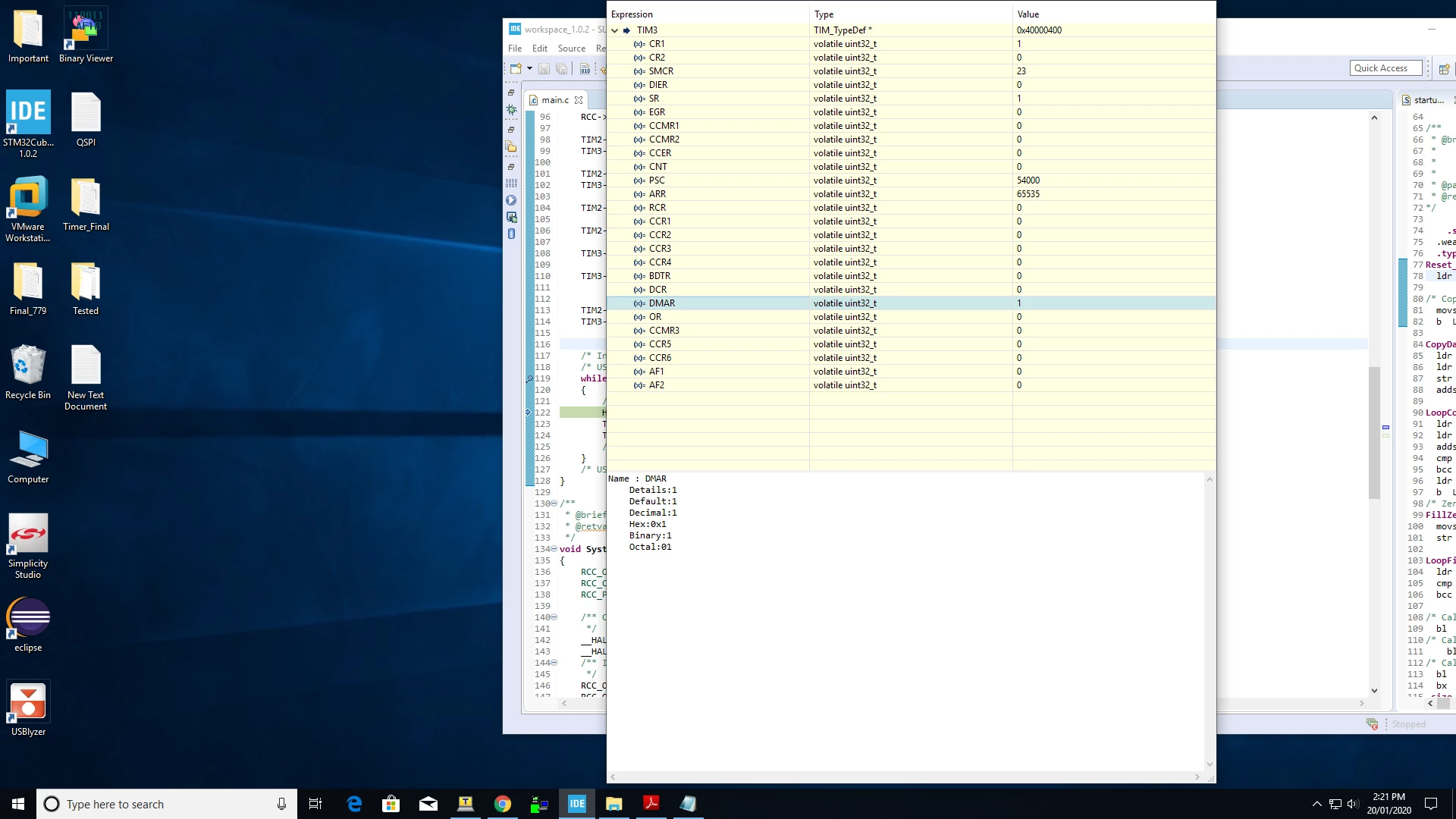

dbgarasiya
Senior
January 20, 2020
0690X00000BwC8lQAF.pngI am attaching you two screenshot , which is at break point before entering in while loop, where i finally read timer count , all configuratin done before this step
for both timers
berendi
Principal
January 20, 2020
You can see the prescaler and period (ARR) values for TIM2. Using these and the APB clock value, you can calculate the period of TIM2. Now multiply this period with the prescaler of TIM3. That's when the counter of TIM3 will be incremented by 1.
