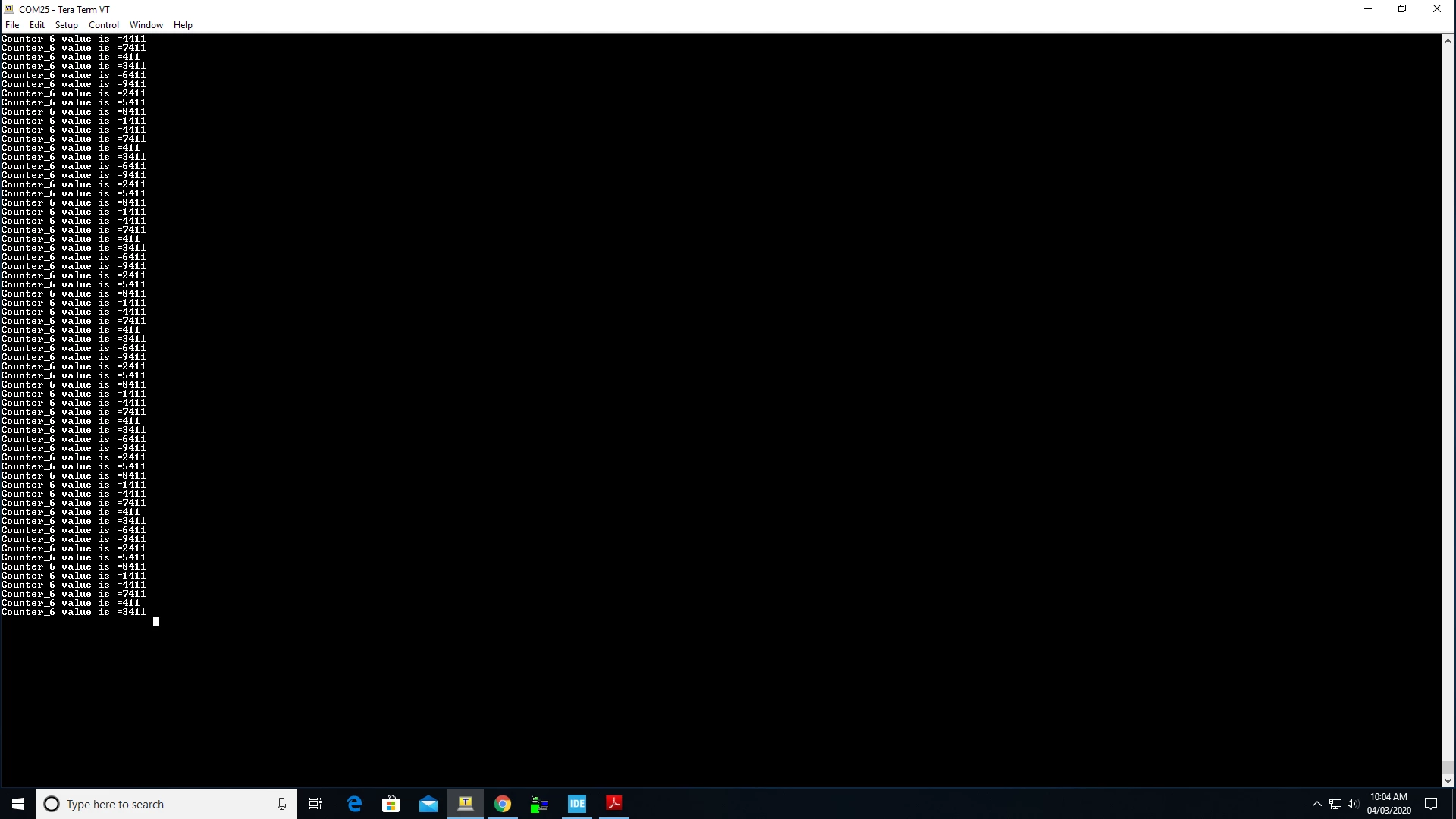

dbgarasiya
Senior
Mar 4, 2020 4:36 AM UTC
it is appoximately 333 us of timer with this configuration .
while (1)
HAL_Delay(1000);
Timer6_Read();
//Read_All_Timers();
i have written my code as above for reading timer count
terminal screenshot i have attached with this post

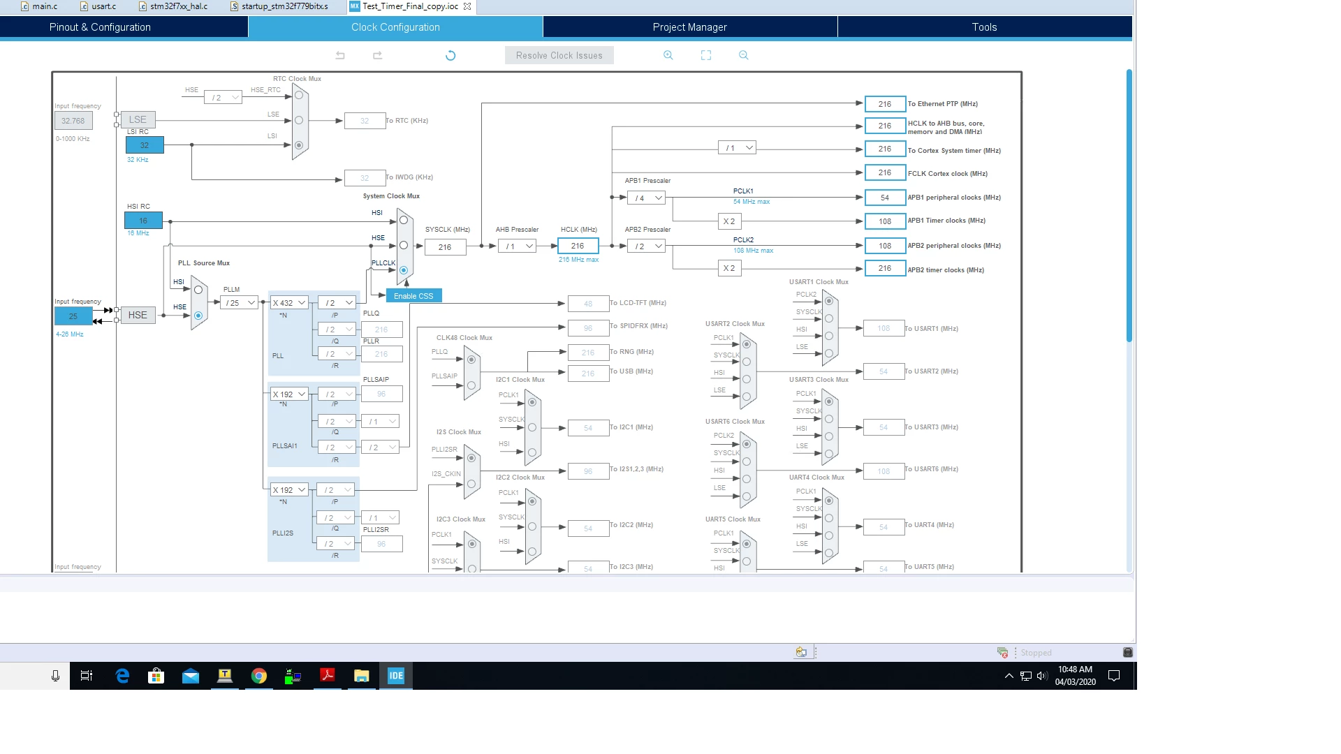

turboscrew
Senior III
Mar 4, 2020 5:13 AM UTC
In that case, check your clock tree.
dbgarasiya
Senior
Mar 4, 2020 5:26 AM UTC
I have used timer 6 which is clocked by timer clock register is RCC_APB1ENR
like this
RCC->APB1ENR |= (1<<4);  // timer 6 which is 108 MHz
i am attaching you my clock configuration sceenshot for this, so you will get better ide about this
