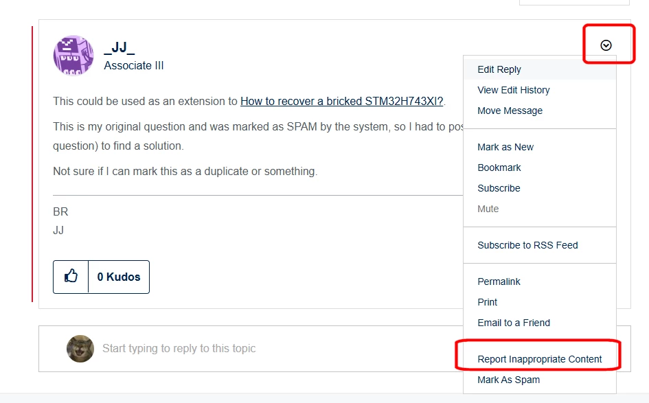

This could be used as an extension to How to recover a bricked STM32H743XI?.
This is my original question and was marked as SPAM by the system, so I had to post another question(the linked question) to find a solution.
Not sure if I can mark this as a duplicate or something.
BR, JJ
Andrew Neil
September 15, 2025
You can use 'Report Inappropriate Content':
Then choose 'Something else' as the reason:
and provide details - including a link to the other post:
A moderator will then be able to delete or merge, as appropriate.
A moderator has now merged the threads.

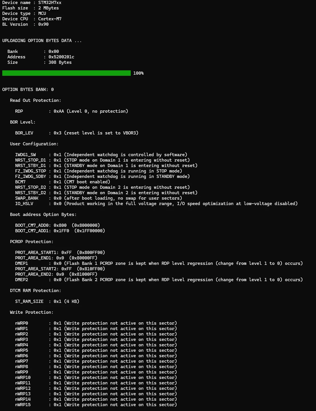

_JJ_Author
September 16, 2025
Hello @Jocelyn RICARD
Thank you for looking into this issue.
Option Byte info you asked for...
BR, JJ

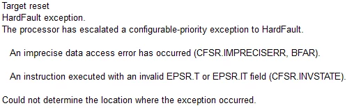

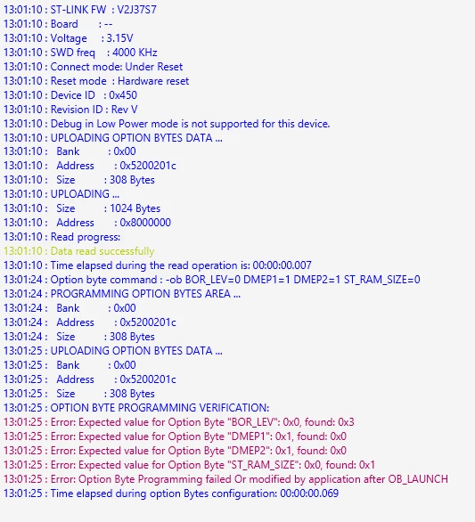

_JJ_Author
September 17, 2025
Okay, so to understand the situation further, I tried flashing a known working firmware code using JLink and ST-vLink, and both worked well using CubeProgrammer, but the STM32H743XI still refused to boot.
At one point, I saw MCU fussing about something along the lines of "RAMCode execution failure" or "RAMCode can not execute"; I don't remember the exact wording. I think this was in the IAR Workbench when I tried to deploy a known working FW code in order to see if I could start debugging again.
Any thoughts on what could be wrong? @Jocelyn RICARD @mƎALLEm
BR, JJ
mƎALLEm
September 17, 2025
As you are able to connect to the device and to flash it , I propose this stage to unzip the attached file that contains a working option bytes. Try to upload them to your device. Please read this article on how to do it: Restoring the STM32 option bytes to their factory settings using STM32CubeProgrammer / section: 1.2 Option bytes factory reset (import option)
_JJ_Author
September 17, 2025
Thank you @mƎALLEm. I tried what you have suggested, CubeProgrammer has come back with the following error.
As per the article used, 'Under Reset' Mode with 'Hardware Reset' to perform this operation.
BR, JJ

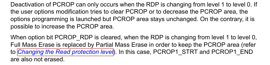

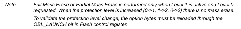

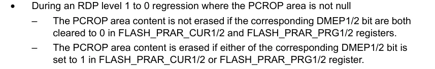

AScha.3
October 6, 2025
@_JJ_
So in this case, sure its not damaged by ESD , last chance :
Before you give up - maybe last action:  to reset the pcrop...whatever its now....
Connect to cpu , maybe using hot-plug or hardware reset, whatever works better, or at all.
So try set :
on L4xx: Uncheck PCROP_RDP + set RDP to level1 (protected) , 01  (or whatever, but NOT 0xCC !);
on H7xx: Check DMEP1 + 2 ,  + set RDP to level1 (protected) , 01  (or whatever, but NOT 0xCC !);
then restart/ power cycle
and then :
on L4xx: set Uncheck PCROP_RDP + RDP to 0xAA , to do regression;
on H7xx: Check DMEP1 + 2 , + RDP to 0xAA , to do regression;
L4:
H7:
then apply....
restart/ power cycle....and we know.
ed...for 'H7.
