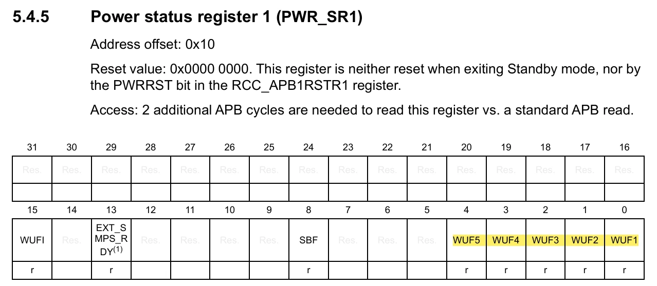

I am using the  Nucleo-L433RC-P board and have configured pin PC13 as SYS WKUP (for the blue top button).
How can I read the state of this pin when the processor wakes up, because HAL_GPIO_ReadPin will not work.
I am sure I used a function or macro to read the state of this pin before, but can't remember how I did it.
I need to distinguish between an RTC wake or a pin wake from shutdown.

Best answer by freeflyer
Thanks TDK
I've come across the same issue I did weeks ago, but this time I know the cause from previous weeks of debugging shutdown and wake.
Your code works when debugging or running, but not in standalone after a cold reset (power loss).
I used...
if (__HAL_PWR_GET_FLAG(PWR_FLAG_WUF1)) {
Just like the PWR_FLAG_SB flag , the PWR_FLAG_WUF1 flag does not work from shutdown, it only works from standby.
It 'appears' to work from shutdown when debugging or running, but it fails to work after a cold reset.
So to get this working, I have had to use standby mode instead of shutdown mode.
See this post I wrote...
https://community.st.com/t5/stm32-mcus-products/shutdown-and-wake-rtc-wkup-work-in-debug-run-but-not-in/td-p/827185
In this case it was with the flag PWR_FLAG_SB, but it looks to be the case with PWR_FLAG_WUF1 too.
To summarise the post above...
In debug or run mode (e.g. via ST-Link or when powered via USB), the power is never fully removed — so:
Certain power control and backup domain registers (like PWR->CSR and RTC backup regs) may retain their values.
The SB flag can remain set, giving the impression it survived SHUTDOWN.
Why it fails in standalone after a cold reset:
In SHUTDOWN mode, only the RTC and backup domain are retained via VBAT.
However, on most STM32s:
The SB flag does not survive SHUTDOWN (it's not designed to — unlike in STANDBY mode).
After a cold power cycle, everything except what’s powered by VBAT is reset — including that flag.
Hence, __HAL_PWR_GET_FLAG(PWR_FLAG_SB) returns false.
TL;DR
PWR_FLAG_SB is only valid for detecting wake from STANDBY, not SHUTDOWN.
It might "appear" to work in debug due to partial power retention or debugger interference — but it's not reliable.
Always use backup register markers or the RTC time to infer wake source across SHUTDOWN.

The pin needs to be initialized as an input pin before HAL_GPIO_ReadPin will read its state. By default, the pin is in analog mode.
If a wakeup pin caused the wake up, a flag is set in RCC->SR1. This is latching--it doesn't reflect current state of the pin.

Thanks TDK
How do I read the  RCC->SR1 register ?  Is there a macro or function ?
August 8, 2025
You can just read it and look for the corresponding bit:
if (RCC->SR1 & RCC_SR1_WUF1) {
Or you can use the READ_REG macro:
if (READ_REG(RCC->SR1, RCC_SR1_WUF1)) {
Of if you prefer HAL:
All equivalent.
