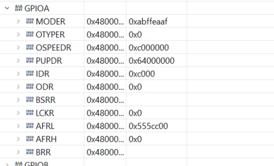

I am trying to init SPI1 (to just receive data qwith MISO) on nucleo G474RE without using HAL libraries.
Can you help me to assess why my code does not work ?
I can't see the clock eventhough SPI1 is enabled

SPI1_SCK is PA5 and its MODER is set to 0b00 i.e. Input instead of 0b10 for AF.
Did not look further.

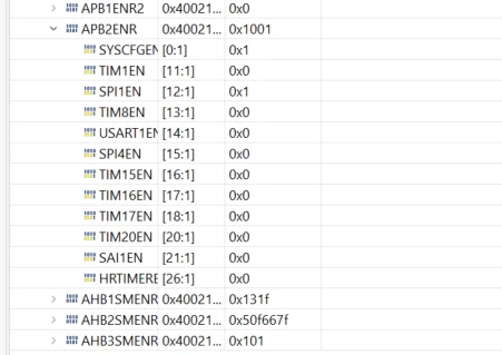

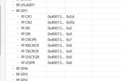

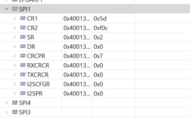

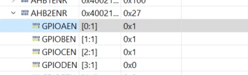

I modified PA5 MODER to AF5 but there should be still something that blocks the SPI1..
I doublechecked the GPIO and SPI clock, the GPIOsettings and SPI1 settings but I cannot find what is still wrong. Can you give a look to the registers again?
The code is just about enabling this SPI1 in order to see the SPI1 clock coming out from my NUCLEOG474RE
GPIOA has clock enalbled0693W00000QLrrsQAD.pngSPI1 clock enabled0693W00000QLrytQAD.pngPA4 PA5 and PA6 all alternate function AF50693W00000QLruIQAT.pngSPI registers

So you see still no clock on PA5 when you write into SPI1->DR, e.g. in debugger? How do the SPI registers change after that write?
I'm not sure what's the behaviour of the internal NSS node if you set SSOE as you've done. Try setting both SSM and SSI.

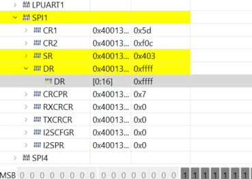

I found that the only way to see the SCK line activated is to write
while (1){
SPI1->DR= something;
if I write directly the registers while debugging the status register is affected (RXNE bit) but I cannot see the SCK outputs (in nucleo G474RE PA5 is connected to LED 2 so it is easy to see)
Maybe this is the right behaviour of the SPI interface?
I thought that after enabling it I would have seen the SCK line activated even if I am not receving data

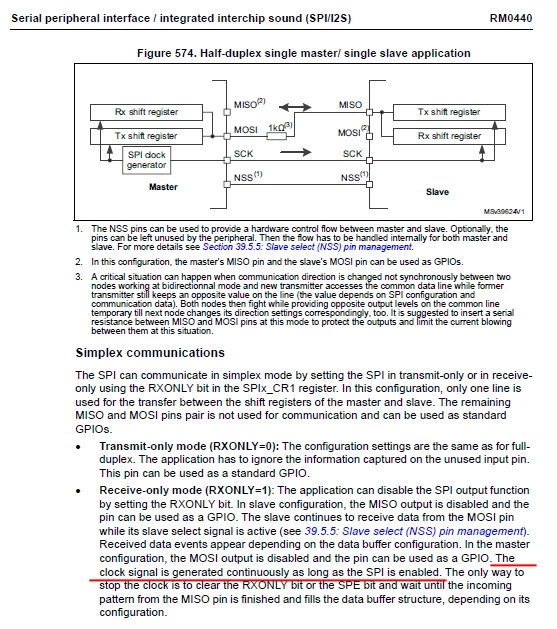

Ah, you're right - this one has a special 'receive-only' mode:
Again, I would suggest starting with HAL to see how that does it, then base your bare-metal on that ...
Andrew Neil
July 22, 2022
So have you set the RXONLY bit?

What I understood is that you recommend to not connect the MOSI pin through AF if not needed. But then who controls when the clock is output on SCK? the SPI enable?
waclawek.jan
July 22, 2022
SCK does not depend on MOSI.
SPI in its most basic form are two shift registers - one for output one for input - and some control logic to generate clocks.
If SPI is set as master and enabled, and then you write to DR, the control logic generates 8 or 16 (or whatever you set) clocks on SPI, and using those clocks it shifts out data from output shift register to MOSI and shifts in data into input shift register from MISO.
If you don't assign any pin to MOSI in GPIO, well simply the internal MOSI output from SPI module is connected nowhere and the shifted out data are lost. If you don't assign any pin to MISO in GPIO, the internal MISO input to SPI module is set to 0, so you will simply receive all zeros.
The mode which is set by RXONLY bit is already an extension to this basic model - if you set that bit, as soon as SPI is enabled, the control logic starts to generate clocks and it won't stop until SPI is disabled.
