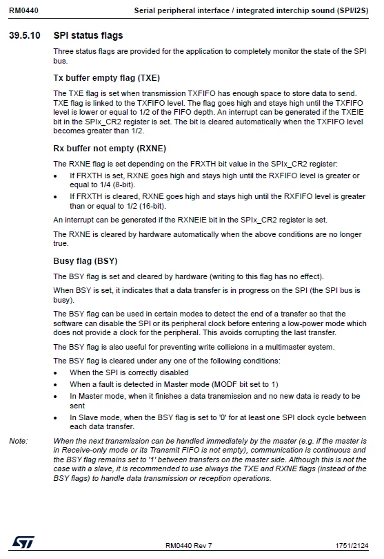

ok thanks. I tried it and it works.
I was afraid of writing to SPI DR before reading it beacuse in some way I thought I could have readback what I wrote. How is this prevented?
Andrew Neil
July 25, 2022
@Tommino​ "How is this prevented?"
There'll be a status bit that tells you when a transfer has completed.
On this chip, you also have read & write FIFOs
