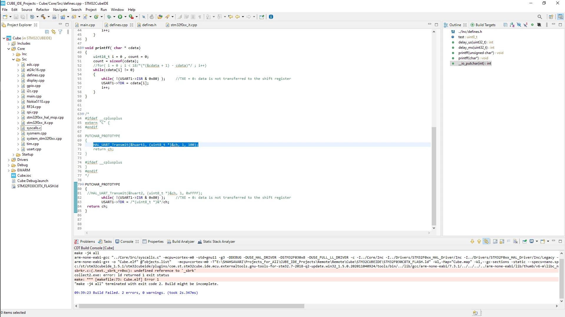

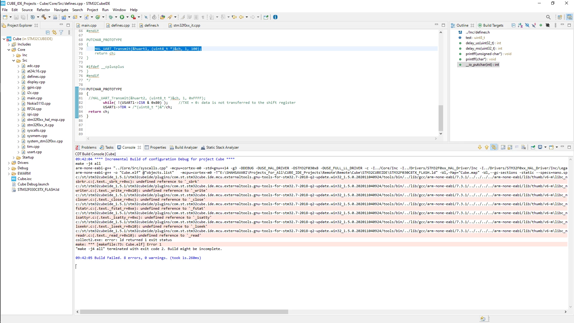

Hi every body.
I have a crazy problem and I`m stuck in a nerve-racking simple work.
working with STM32CubeIDE 1.5.1, code created from stm32cubemx 6.5.0
project converted to c++
wanna retarget printf to uart
in a .h file have this:
#ifdef __GNUC__
 #define PUTCHAR_PROTOTYPE int __io_putchar(int ch)
#else
 #define PUTCHAR_PROTOTYPE int fputc(int ch, FILE *f)
#endif
and in the .cpp file with the same name, have this:
PUTCHAR_PROTOTYPE
while( !(USART1->ISR & 0x80) ); //TXE = 0: data is not transferred to the shift register
USART1->TDR = ch;
 return ch;
apart from the odd problem of jumping into HardFault_Handler() when using HAL_UART_Transmit()
I can never build the project successfully, I do have lots of different errors when changing all files to .cpp. the only file I dont change to .cpp is syscall.c, with that I get the first_error.
0693W00000SvlBWQAZ.pngand when changing to syscalls.cpp, I get the second_error.
