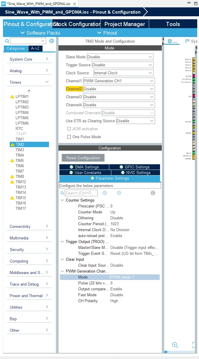

PWM Output (TIM2_CH1):
The PWM output is generated on PE0:
Notes:
TIM2 configured for PWM mode 1
Channel 1 is used
Output routed to PE0 (verified)

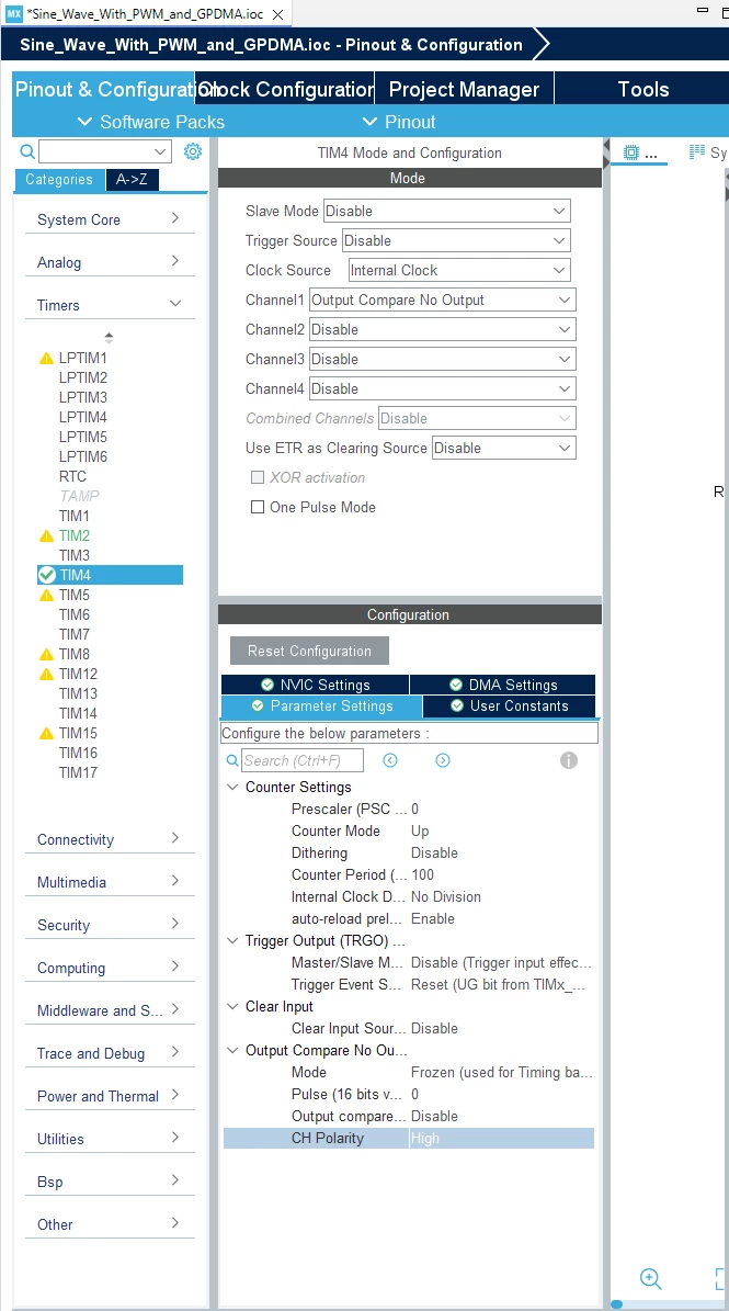

TIM4 Configuration(To Operate in OC Mode On CH1):
Here is how TIM4 is configured:
Note:
Number 100 according to the guide (will be replaced in the code).

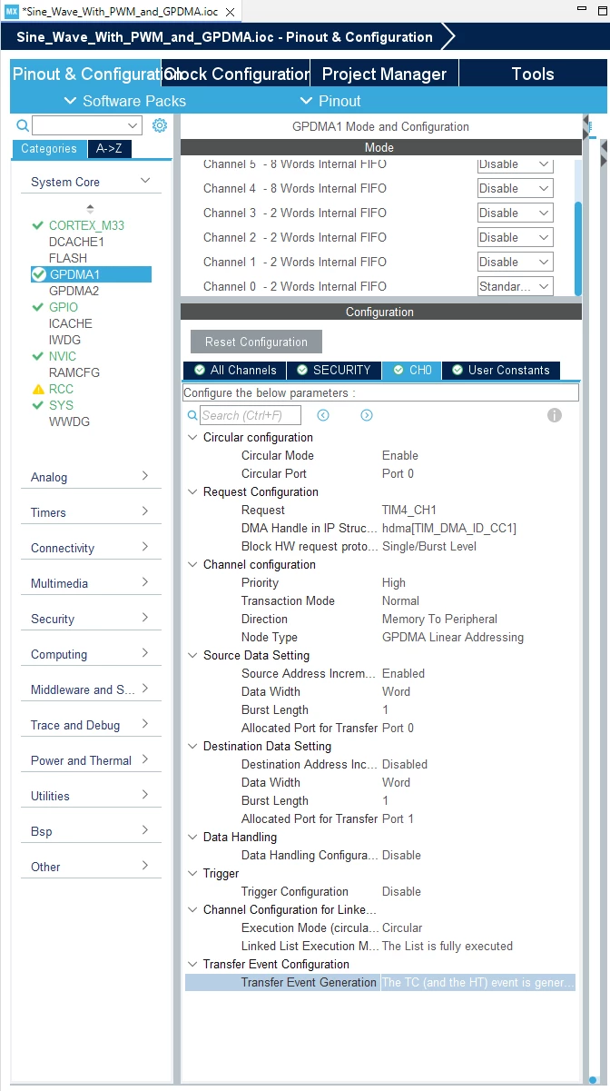

GPDMA Configuration:
Here is how I configured GPDMA1 Channel 0:
Notes:
Source Increment: Enabled
Destination Increment: Disabled
Mode: Circular
Request Source: TIM4_CH1
Direction: Memory-to-Peripheral
Adds the main code at the end.

What is the correct sequence to start a GPDMA standard request transfer triggered by TIM4_CH1?
Is there any extra configuration required for GPDMA Standard Mode in STM32H5?
Is there a minimal example or reference project for sine wave generation with PWM and GPDMA (without Linked List Mode)?
What could prevent GPDMA from starting even if all configurations seem correct?
Do I need to manually trigger anything additional to "arm" GPDMA transfers in Standard Request Mode?
Are there different code commands for GPDMA than classic DMA?
