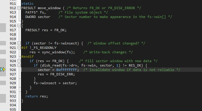

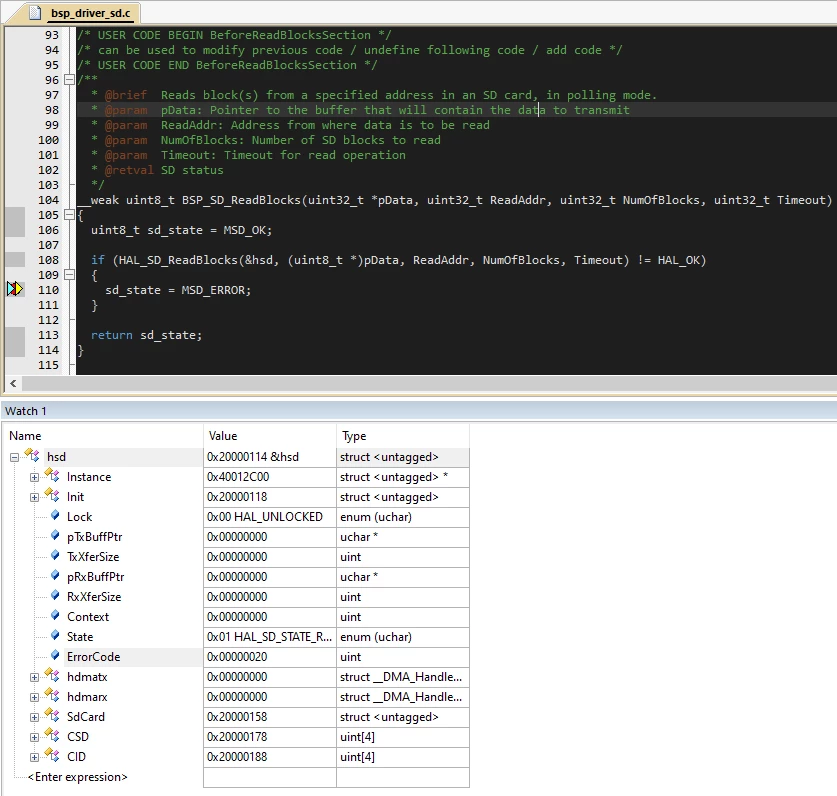

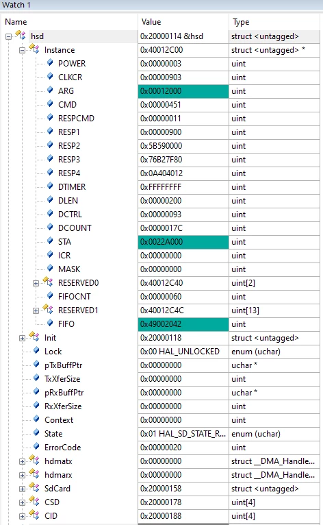

I am looking at "bsp_driver_sd" layer error "HAL_SD_ERROR_RX_OVERRUN" which occur here:

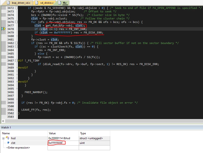

It seems to originate from "f_open" when it tries to seek to end of file, fails on "get_fat" (but it seems to be random and sometimes it fails on other f_open places when HAL_SD_ReadBlocks returns HAL_SD_ERROR_RX_OVERRUN):
f_open->get_fat->move_window->SD_read->disk_read (BSP_SD_ReadBlocks)->HAL_SD_ReadBlocks returns HAL_SD_ERROR_RX_OVERRUN and f_open fails with FR_DISK_ERR because get_fat returns clst = 0xFFFFFFFF.
Can you point to more specific point where should I debug further?
