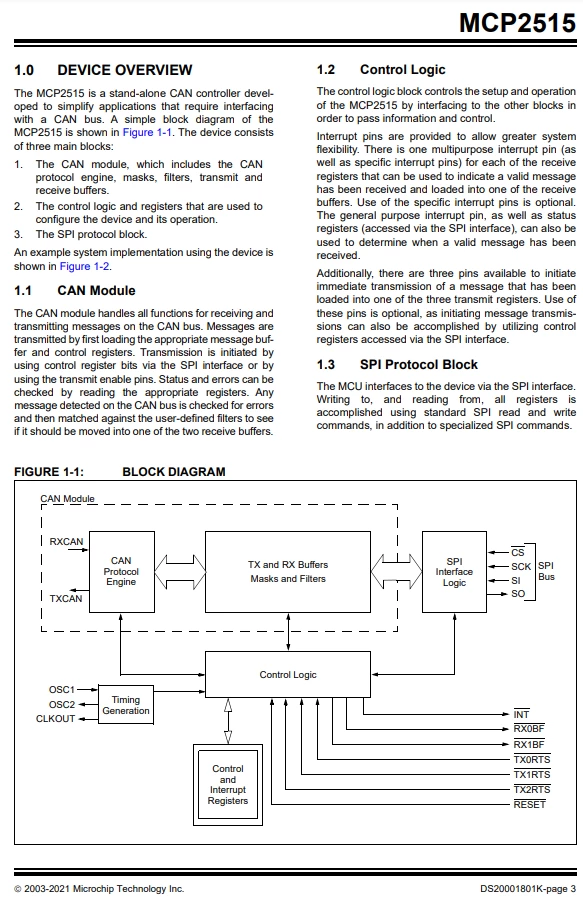

@Kenno wrote:
I got an MCP2515 that wants an ISP (sic) type signal
So this:

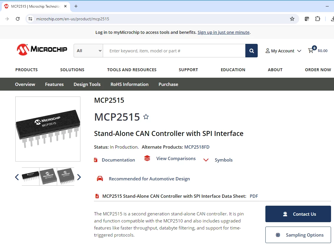

As it says on the tin, it's a "Stand-Alone CAN Controller with SPI Interface" - not "ISP".
SPI is a very long-established and widely-used bused - you can find plenty of resources describing it; eg,
https://en.wikipedia.org/wiki/Serial_Peripheral_Interface
https://learn.sparkfun.com/tutorials/serial-peripheral-interface-spi/all
Yes, STM32s - including the HAL - support SPI
@Kenno wrote:
is there an easy way to make the STM32 convert the code from CAN to ISP?
I think you've missed the point of the MCP2515 !
It's the MCP2515 which does the "conversion" between CAN and SPI !
You'll need to start by studying the MCP2515 documentation:
https://www.microchip.com/en-us/product/mcp2515
