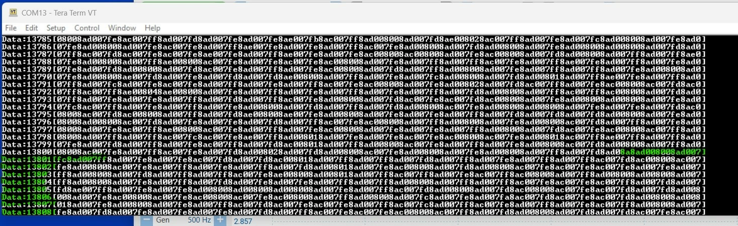

I am now able to start and stop the spi/dma via a USB-CDC VCOM channel and log the data I receive. In running the system I have noted a peculiar annomaly in the data, a picture (.jpg) of which is attached. While this does not happen often, and the occurence is intermittent, it is a BIG issue, re reliability and self diagnosis; this concerns me.
The format of the data I recieve from my dual synchronous adc is shown in the attached.pdf, effectively 4 bytes as follows 0000 xxxx xxxx xxxx yyyy yyyy yyyyy 0000  where x is a 12 bit sample (chn A)  >> 0 and y a 12 bit sample (chn B) << 4.
It would appear that aperiodically there is a glitch in synchronisation of the mapping from the spi fifo to the dma? This results in the 4 byte data being barrel-shifted by a byte, hence corrupting the values received. Do you have any idea what can be causing this, and if you do, how do I fix it please? I can confirm from oscilloscope measurement that the SPI signals on the bus are correct, are not displaying any errors and accurately reflect the value of the analoue signals being measured.

waclawek.jan
August 8, 2023
> I use a USB-CDC (vcom) transfer, not uart
CDC uses Bulk transfer, which does not have guaranteed bandwidth. In other words, your problem may be at the USB side, not the SPI side.
Add some framing to your data.
waclawek.jan
August 9, 2023
The brackets are the framing I was talking about - I did not notice this is screenshot of Tera Term, I though it's your program which already "reassembled" the data, sorry.
I though it is unlikely SPI drained by DMA to overrun.
On second thought, maybe it does not, and maybe it's the way how you format the data for transmission. You appear to use Cube/HAL - do you use RTOS, too? Do you output data using printf()? If both answers are yes, try writing a simple routine which outputs data without printf().

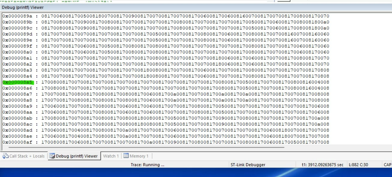

Greg Horler
August 10, 2023
Don't know what happened there?
I simplified the code to use a single printf to print a packet index (count) and packet data. This reduces the overhead to simply formatting the received data and a single print. Is this what you meant by >>" writing a simple routine which outputs data without printf()."
I also have an option to conduct multiple samples of the dma using normal mode. The error still there!
BTW  what do you mean by "...writing a simple routine which outputs data without printf(). "
I'm now attempting to establish if the byte shifting occurs with the spi running on its own (i.e. without the dma), I will post when I have some results.
