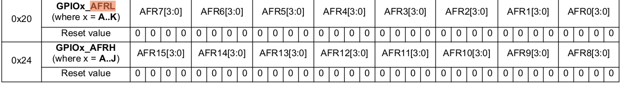

OK, need some hours to understand a part of your answer, but so far an example for my Clock on PI1:
  1. Datatsheet In the Table 12. STM32F745xx and STM32F746xx alternate function mapping (continued): I see that I have to map PI1-Pin to AF5 (for I2S2_CK)
  2. So the "number"of function is 5
  3. In the RM on page 199 (GPIO) I read that all GPIOs have the alternate function selection registers GPIOx_AFRH and GPIOx_AFRL. But what exactly I have to write in to this registers was not clear for me. Do I have to write a five somewhere? In the AFR5-Section?0690X000006BvDtQAK.png
  4. In the MODER Register (GPIOI__MODER) i have to set the forth bit and clear the third, to say PI1 has an alternate function.
In addition I have also to setup the ouput states, speed selection etc. How do I change this registers in C? Which function do I have call, or which Macro do I have to use?
waclawek.jan
August 22, 2018
As I've said I don't Cube, but if you look at the examples, you certainly notice that there is something like GPIO_Init() or similar function, and in there, a struct is filled with things like "mode is AF" and "number of alternate function" and then a initialization function (HAL_GPIO_Init()) is called, which does the "magic". They may be initialized also elsewhere, in some callback called from the I2S initialization, I don't quite get Cube's logic of doing things (that's why I dont' use it).
Yes; but in Cube the "magic" in the init function as mentioned above does that. I do this using the usual bit manipulation routines, utiilizing macros defined in the standard CMSIS-mandated device header:

 GPIOI->AFRL = (GPIOI->AFRL
   & (~GPIO_AFRL_AFRL1)     // clear the field
 ) | (0
   | (GPIO_AlternateFunction_I2S2 * GPIO_AFRL_AFRL1_0)  // I2S2_CK

Unfortunately the macros GPIO_AFRL_AFRL1, GPIO_AlternateFunction_I2S2 and GPIO_AFRL_AFRL1_0 are not defined in my stm32f746xx.h What have you defined there?
Also for  GPIOI->AFRL I had to take GPIOI->AFR[0]

> GPIO_AFRL_AFRL1 [...] GPIO_AFRL_AFRL1_0
I don't use 'F7xx, but generally the scheme is the same. As I've said (and for the last few years I keep saying loudly and annoyingly wherever I meet ST employees, to no effect) ST doesn't define most of the needed constants in the device headers (they define them in the "libraries" headers, mostly in a non-systematic way, different in SPL and Cube) so I am augmenting the headers myself, trying to stick to a scheme used by ST where similar is existing, and sticking to my own scheme (with "final functionality" after double-underscore) where not.
In the headers I took from SPL and early Cube, GPIO_AFRL_AFRL1 was defined but GPIO_AFRL_AFRL1_0 wasn't so I defined them myself. However, looking into [STM32Cube_FW_F7_V1.7.0]\Drivers\CMSIS\Device\ST\STM32F7xx\Include\stm32f746xx.h , I see
My own. Make it 5 if most of the I2S2 functionality is in the 5th column of the pin-AF table.
Yes, I have
#define AFRL AFR[0]
#define AFRH AFR[1]
I have a problem with the device headers not following the RM nomenclature, however failed it is.

Hmm.. when I read this:
http://www.se.rit.edu/~swen-563/resources/STM32L476/GPIO%20and%20Alternate%20Function%20Setup.pdf
.. and combine it with your code it shoud be:
#define GPIO_AFRL_AFRL1 ((uint32_t)0x000000F0)
#define GPIO_AFRL_AFRL1_0 ((uint32_t)0x00000100)
#define GPIO_AlternateFunction_I2S2	 ((uint32_t)0x00000005)
is this correct?

August 23, 2018
 #define GPIO_AFRL_AFRL1_0 ((uint32_t)0x00000010)
