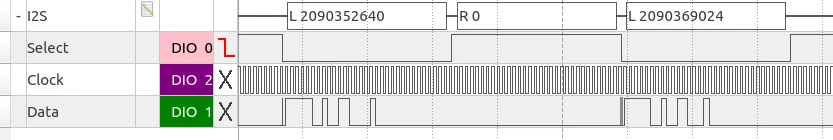

I've been trying to make the connection work for the last couple of days. The MXCube helped me a little bit to get ahead. However, I still have problems. The goal is the continuous streaming of data from a SPH0645LM4H-B microphone.
Now I try to save the data into an array via DMA. I have configured everything to 32-bit. The microphone should give 18 bits of information. The way I look on the oscilloscope doesn't look bad. But I can't get the data properly into an array.

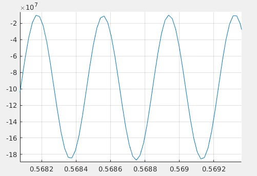

Another decisive factor was that I don't store the data in a 32-bit array, but in a 16-bit one. The DMA stores the high-16Bit and the low-16Bit in the array in the wrong direction.
Also the function HAL_I2S_Receive_DMA(I2S_HandleTypeDef *hi2s, uint16_t *pData, uint16_t Size) is a bit tricky. Size can be a maximum of 2^14. At a sample rate of 48000 this is just enough for 0.3 seconds. I was able to solve the problem in such a way that the triggered interrupts
HAL_I2S_RxHalfCpltCallback and HAL_I2S_RxCpltCallback, one half each of the DMA array can be written to a larger (32Bit) array. There I can also reverse the high-16Bit and low-16Bit. The DMA is operated in circular mode.
Now this works so far and I can fill the RAM to the limit with data from the microphone. Only the solution is a bit improvised. Is it possible to configure the DMA so that the 32Bit value is directly correct? E.g. by writing in the memory in the other direction?
Screenshot of the microphone-data with a 2.6kHz sinus-signal:
waclawek.jan
Sep 6, 2018 3:26 PM UTC
I understand your sentiment, but in many if not most audio applications the data need to be manipulated somehow anyway.
No, i.e. 32-bit I2S in the SPI/I2S module with its 16-bit data register inevitably results in the data swap (and the more usual 24-bit I2S feels maybe even more weird in this regard). There's no way to "reverse" the DMA's address register increment direction, and the DMA does not support reordering even in the FIFO mode. If this is a priority for you, use the SAI module instead of SPI/I2S.
