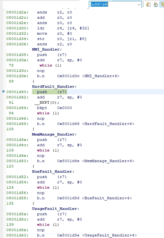

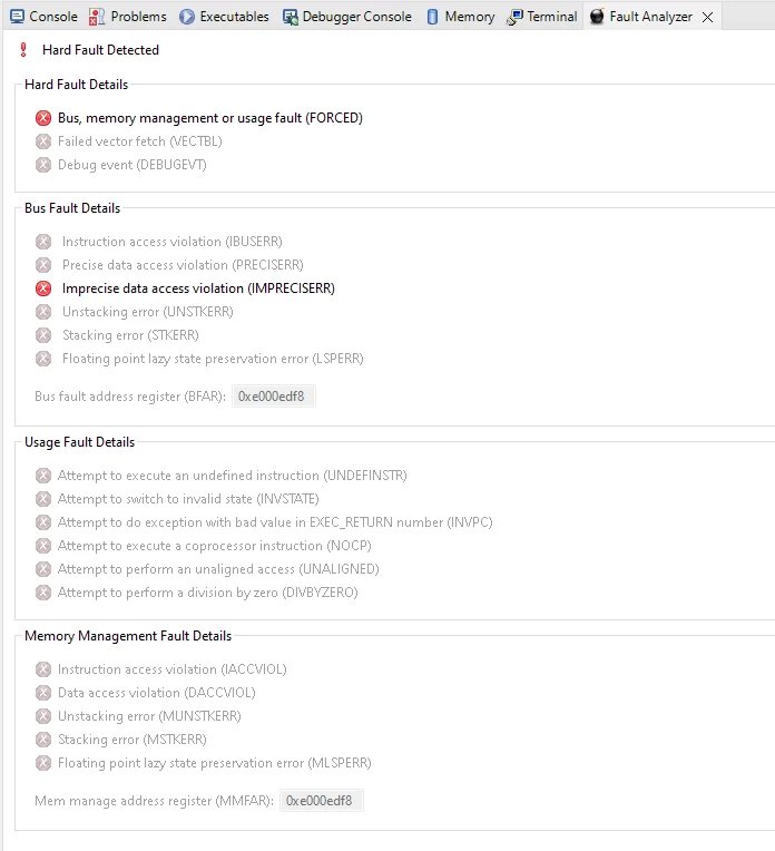

The optimization level is set to be 0, and the Fault Analyzer and the address of the PC are shown in the image below. But I couldnt figure out how fix this hardfault.

If it's in the HardFault Handler and that just does while(1), there's no point in illustrating that.
Show the CODE that's actually failing and the REGISTERs
Imprecise suggests its a failing memory write just prior.
This is what I use in KEIL
https://github.com/cturvey/RandomNinjaChef/blob/main/KeilHardFault.c
I'm interested in the PC of the FAULT, the registers that code is using, and perhaps LR to understand the next level up, where the current function was called, so I can check the passed parameters, or perhaps add code to sanity check them. ie not NULL or Errant Pointers, etc.
Check size fields, if they describe bytes or array elements.
