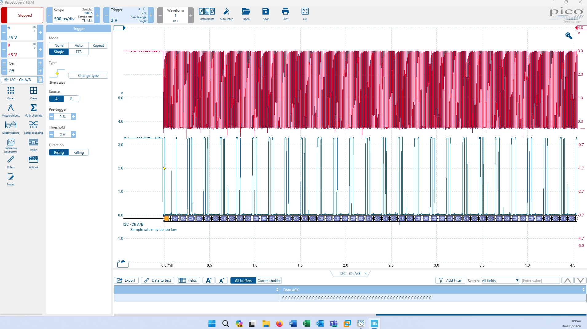

Hi There,
I have searched a lot about the  HAL_I2C_Mem_Write_DMA problem and seems like i have not found anywhere else this issue has been solved.
Can anyone contribute if someone has solved it.
Thanks
Ganesh-K-GrgBest answer
June 4, 2024
Hi Andrew,
I found the solution from this link:-
https://community.st.com/t5/stm32-mcus-products/hal-i2c-dma-bugs-why-does-this-simple-dma-code-not-work/td-p/136667
I need to add below code and enable the I2c event interrupt. Seems working fine. But I need to tune my code a little bit more.
void HAL_I2C_MemTxCpltCallback(I2C_HandleTypeDef *hi2c)
	if (hi2c->Instance==hi2c1.Instance)
		HAL_DMA_Abort_IT(hi2c->hdmatx);
void HAL_I2C_MemRxCpltCallback(I2C_HandleTypeDef *hi2c)

Hi Evangelist,
Calling a write function to write about 6 bytes. But it keeps sending contineously a lot of data.
HAL_StatusTypeDef ret = HAL_I2C_Mem_Write_DMA(&hi2c1, (20 << 1) | 0, 4, 1, &to_reg[0], 6);
