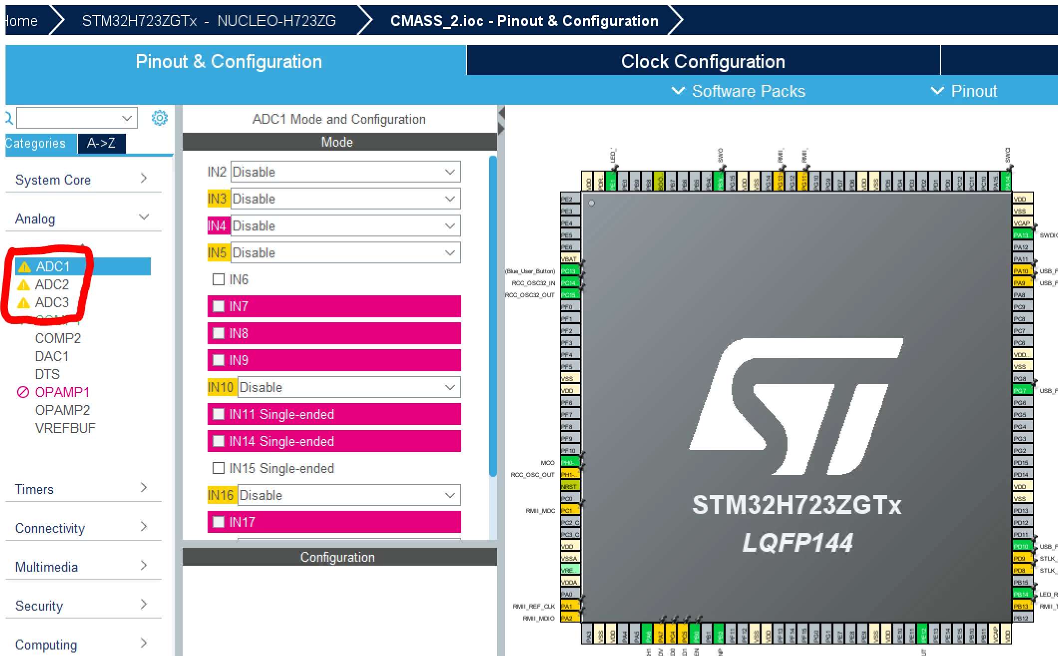

Here is the IOC file.
Also thanks the ADC app note.
The initialization was generated by CubeMX...
Louis
Apr 2, 2022 12:38 AM UTC
The ADC isn't enabled in the IOC you attached.
But see my edit above, it definitely seems like CubeMX can set a too-high ADC clock without any warning. I could be missing something.

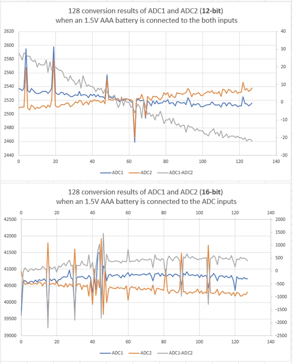

The battery test
I connected an 1.5V AAA battery to both ADC inputs: ADC1_INP15 (PA3) and ADC2_INP10 (PC0). I used my application which takes samples with 12800Hz and starts the ADCs simultaneously form TIMER_1. When EOC (End of conversion) interrupt happens I write the conversion results of ADC1 to DAC1.CHN1 (16-bit to 12-bit conversion is needed). When both ADC results are available then I subtract ADC1 conversion results from ADC2 conversion results and write the difference code to DAC2.CHN2. This way I can check the ADC1 conversion results and the difference between ADCs on an oscilloscope. Each conversion is saved in 3 buffers. The buffers can store the last 128 ADC1 and ADC2 conversion results and the difference between ADCs.
I would expect that the difference signal is around 0V (+/- 1-2bit). Don’t forget: both ADC inputs are connected tot same 1.5V battery. But what I get is 50mV sine around 50kHz! 50mV difference between ADCs connected to same 1.5V battery, even not DC signal? That is unexpected..
0693W00000LwphVQAR.bmpIn order to make sure this is not a scope issue put a breakpoint and halted the program when the buffers were full. Then I copied out the last 128 samples from the ADC1, ADC2, and DIFFERENCE buffers from the CPU memory. I simply pasted the data into an Excel sheet and created a graph. I repeated this test with 12-bit and 16-bit ADC modes.
0693W00000LwpidQAB.pngThe scope results are right. This is AD converter issue. I still do hope that I did something wrong during the initialization and somebody can explain what. STM experts?
Thanks for any help!
Louis
