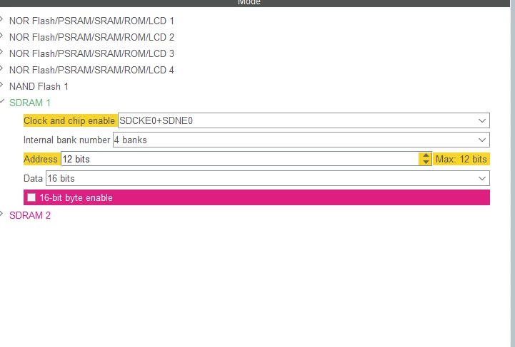

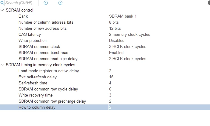

I'm working on a custom board with a STM32H723ZG. I'm also using external sd ram part  IS42S16400J-6TL found here (https://www.digikey.com/en/products/detail/issi-integrated-silicon-solution-inc/IS42S16400J-6TL/2708625). I've followed the excellent sd ram tutorial here: https://community.st.com/t5/stm32-mcus/how-to-set-up-the-fmc-peripheral-to-interface-with-the-sdram/ta-p/49457 which was how I was able to determine the values in the stm32 cube IDE. The FMC init generated function runs without error (MX_FMC_Init which calls HAL_SDRAM_Init). I have posted the cube IDE set up below.

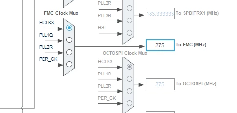

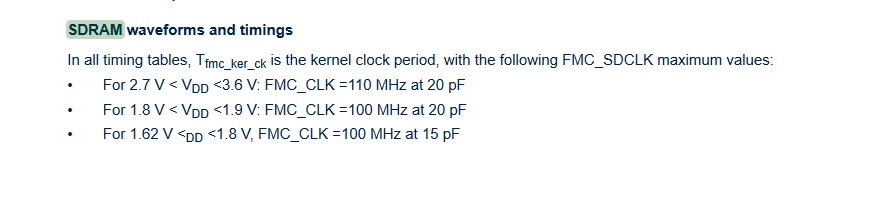

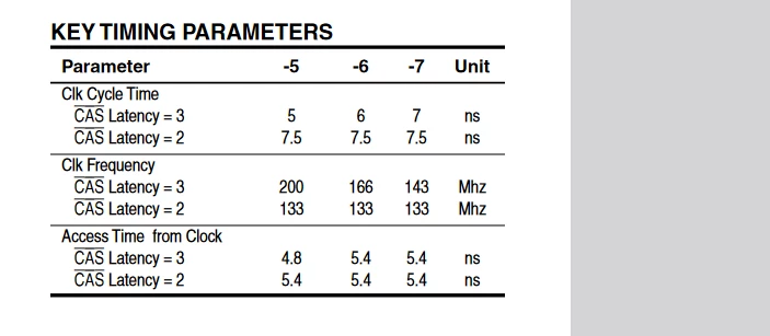

My FMC clock input is using HCLK3 at 275Mhz, but the sd ram common clock is 3 HCLK cycles, so this should put the sd ram clock at 91.66 mhz. I believe this is below the 110 mhz limit for my voltage range (3.3V).

DataSheet SymbolDatasheet valueCubeMx nameCubeMX value
Tmrd2 cyclesLoad Mode Register to Active Delay
TXSR66 nsexit self refresh delay7
tRAS42 ns (min)self refresh time4
trc60 nssdram common row cycle delay6
tDPL2 * clk (nanoseconds)Write Recovery time3twr - tcd (5 -2) =3
tRP15 ns common row precharge delay2
tRCD15 nsrow to col delay2

I've solved the problem. When you generate fmc related files in cubemx, they can be different if your target is a ST board, vs just the chip. The following defines and sd ram commands were present in the discovery board, but were not being generated when I built for our custom board. Adding these in allowed me to see the clock signal (FMC_CLK) and then I was able to read sd ram
