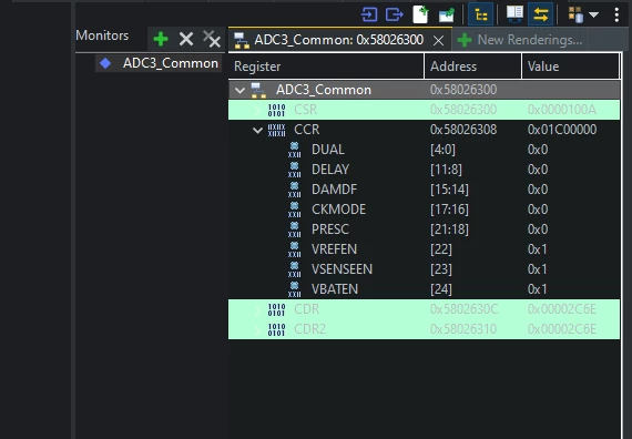

LL_ADC_SetChannelSamplingTime(ADC3, LL_ADC_CHANNEL_TEMPSENSOR, LL_ADC_SAMPLINGTIME_387CYCLES_5);
For ADC3, the sampling time need to be replaced by LL_ADC_SAMPLINGTIME_ADC3_247CYCLES_5
On other hand, can you confirm that bit TSEN is set to 1 ? It's located in ADC3_CCr register bit 23.

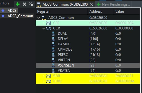

And when I look into my registers, bit TSEN I don't see. Interesting. But in my eclipse aplication it has name VSENSEEN. And it is set to 0.
https://www.st.com/resource/en/reference_manual/dm00314099-stm32h742-stm32h743-753-and-stm32h750-value-line-advanced-arm-based-32-bit-mcus-stmicroelectronics.pdf#page=1042
Nov 22, 2021 2:58 PM UTC
I'm sorry I took the wrong reference manual...Sampling time doesn't need to be change...
Try to force this bit just before starting your ADC and see if there is any change. It seems that the TempSensor is not enable.

I'm approaching a solution. In some pdf I read about DCache. So I tried to update my code:
SCB_InvalidateDCache_by_Addr((uint32_t*) tempSensor, (uint32_t) (sizeof(tempSensor) / sizeof(uint16_t)));
UartPrint("TEMP=%d; PF10=%d; VREF=%d", GetMCUTemperature(), GetPF10Voltage(), GetVrefVoltage
// Using function for read temps and voltages
uint32_t GetMCUTemperature(void) {
 return __LL_ADC_CALC_TEMPERATURE(3300, tempSensor[0], LL_ADC_RESOLUTION_16B);
uint32_t GetPF10Voltage(void) {
 return __LL_ADC_CALC_DATA_TO_VOLTAGE(3300, tempSensor[1], LL_ADC_RESOLUTION_16B);
uint32_t GetVrefVoltage(void) {
 return __LL_ADC_CALC_DATA_TO_VOLTAGE(3300, tempSensor[2], LL_ADC_RESOLUTION_16B);
I used a freezer before starting the MCU. Now I have a problem with the PF10 value. This value is not measured.
