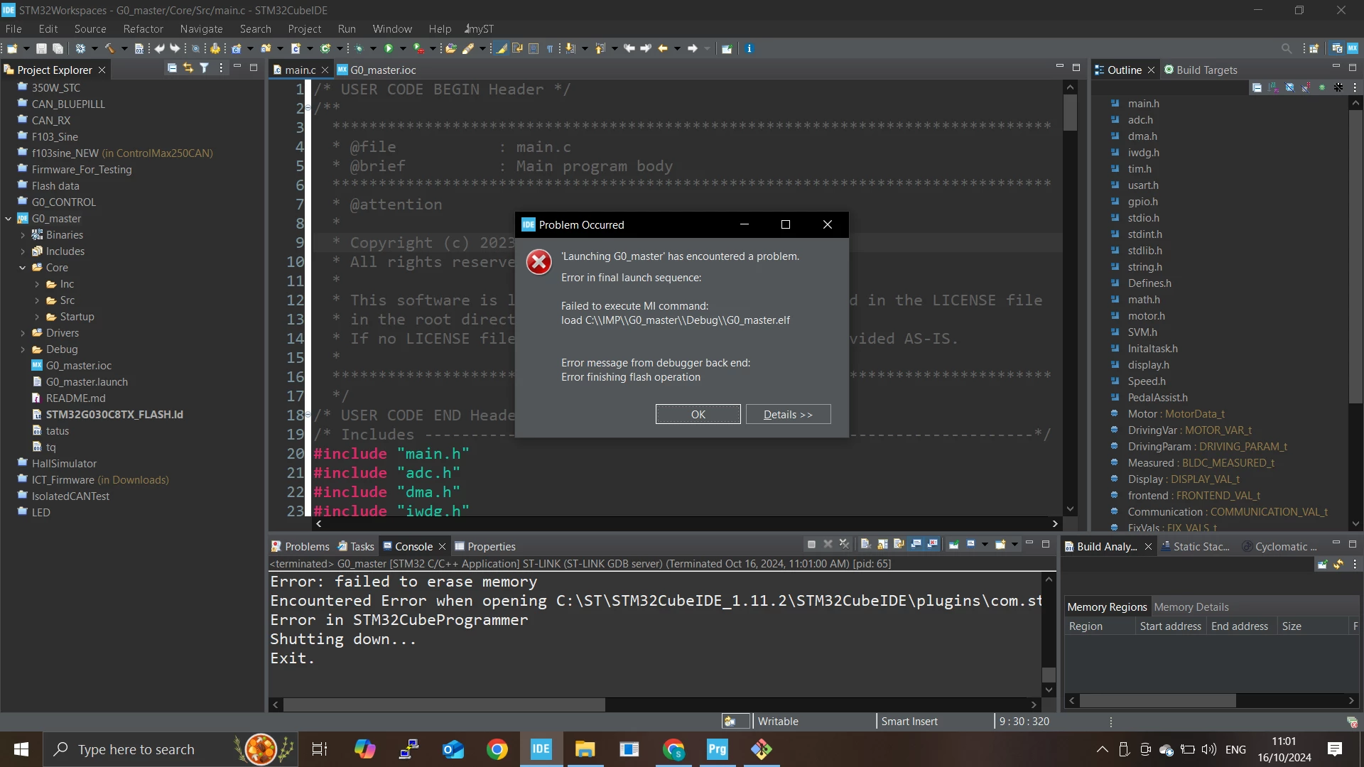

I am working on stm32g030c6t6 MCU
When i have select PB11 PA7 and PA5 has GPIO_OUTPUT it is giving issue in flashing program
Please tell me solution

    GPIO configuration is done by your code, after reset, typically in main(). So GPIO settings shouldn't matter for flashing. Use STM32CubeProgrammer for flashing, it has variuos options like connecting under reset at different speeds.
    Your question is missing details: What is connected to the outputs or other pins? Boot mode (pins and option bytes)? Is the flash empty or was it programmed before? Known good hardware or new/own design? ...
