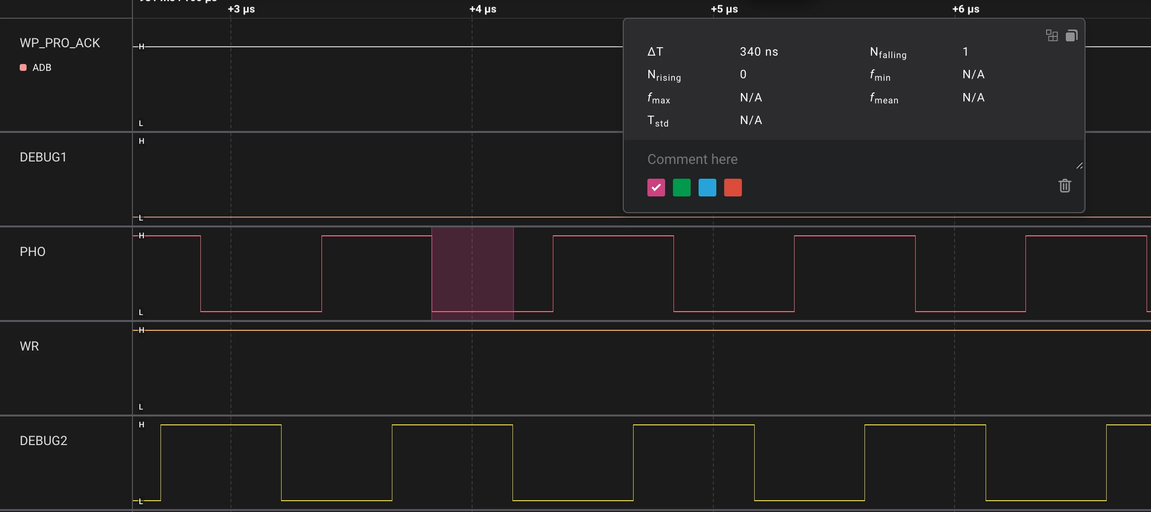

I have a STM32F411 Blackpill connected on an Apple II Bus Slot.
The Apple II has a clock (Phi0) close to 1 Mhz. Phi0 is connected to Pin A2 where I have setup a Falling & Rising Edge interrupt.
The GPIO B12 is used to check the latency between each Phi0 phase,
- at the falling edge of Phi0 B13 is clear
- at the rising edge of Phi0 B13 is set,
I have nothing else running on this STM32, I am observing a delay (avg 335 ns) between the interrupt detection and GPIO set or clear.
Using the logic analyzer:
Debug2 is the GPIO B13

Why do I have a huge latency between B13 & PHI0 ?
What can I change / do to reduce that gap ?

335ns at 100 MHz is 33 ticks. That's about as good as you're going to get with this approach. Might be able to get it down to low 20s.
1) There's a 12-cycle delay for the ISR to fire on the M4 core.
1a) I suspect there are a few clocks of delay between the actual edge and the interrupt becoming pending.
2) There are additional flash wait states if the ISR instruction is not in memory.
3) You have a few instructions before actually setting the GPIO value. These use the same bus to communicate as setting the GPIO. Look at disassembly to see what it's doing.
4) The write to GPIO is not instant and will take a few cycles as well.
You can eliminate (2) by putting instructions in RAM. And you can affect (3), but only slightly.

Why do you think it is not normal?
What results are you expecting instead?
Did you look at the disassembly? Cortex M4 has (minimum) cycle counts for each instruction. Add them up and compare that to what you're seeing.

It is more like 500 ns  means 50 cycle (OK 12 for the ISR), but stil 38 cycle to trigger a GPIO
seems strange !

Here are all the instructions it's doing after the IRQ fires but before GPIO is actually set.
 465 	EXTI2_IRQHandler:
 474 0000 0E4B 		ldr	r3, .L18
 475 0002 5B69 		ldr	r3, [r3, #20]
 477 0004 13F0040F 		tst	r3, #4
 478 0008 16D0 		beq	.L15
 480 000a 0C4B 		ldr	r3, .L18
 481 000c 0422 		movs	r2, #4
 482 000e 5A61 		str	r2, [r3, #20]
 485 0010 03F54443 		add	r3, r3, #50176
 486 0014 1B69 		ldr	r3, [r3, #16]
 488 0016 1340 		ands	r3, r3, r2
 490 0018 094A 		ldr	r2, .L18+4
 491 001a 1370 		strb	r3, [r2]
 494 001c 1378 		ldrb	r3, [r2]	@ zero_extendqisi2
 496 001e 3BB9 		cbnz	r3, .L17
 498 0020 03F18043 		add	r3, r3, #1073741824
 499 0024 03F50133 		add	r3, r3, #132096
 500 0028 4FF08052 		mov	r2, #268435456
 501 002c 9A61 		str	r2, [r3, #24]
18 instructions, 1-3 cycles each. You see an average of 21 cycles (+12 for ISR fire). Seems reasonable. Why does that seem strange?

Hello Jan,
Exactly this is what I have read in the datasheet, the RP2040 is ale to manage a 8.6 ns gap...
Is there a STM product (cheap) be able to achieve the same results ?
Vincent
waclawek.jan
May 12, 2025
I don't think there is any STM32 containing hardware which could effectively emulate a parallel memory.
