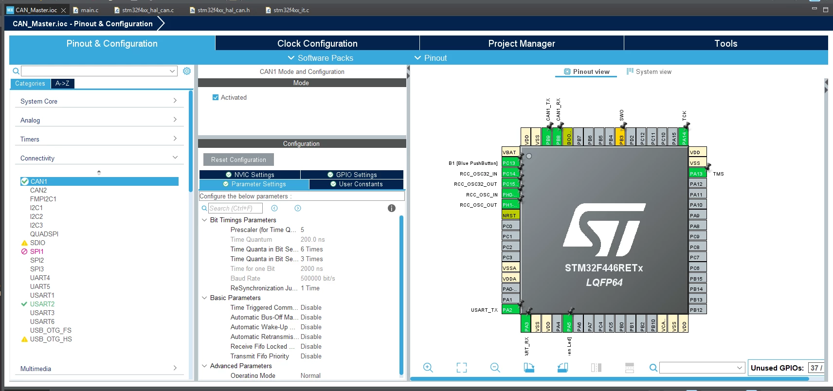

Hello STM32 Community,
I'm trying to implement CAN communication on my Nucleo F446RE board and I'm facing some challenges getting it to work properly. I've attached screenshots of my .ioc configuration and the auto-generated code from STM32CubeIDE for reference.
Current Setup
  • Hardware: STM32 Nucleo F446RE
  • Transceiver: SN65HVD230
  • Baudrate: 500kbps (Prescaler=5, BS1=6TQ, BS2=3TQ)
  • IDE: STM32CubeIDE
Issues I'm Experiencing
When trying to transmit CAN messages, I'm getting "TX Error" and "CAN State: RESET" messages through UART. The free TX mailboxes show as 0, which seems unusual for initialisation.
What I've Tried
  1. Configured CAN1 in normal mode
  2. Set up the pins PA11 (RX) and PA12 (TX) for CAN
  3. Implemented basic transmission code using HAL_CAN_AddTxMessage()
  4. Added proper termination resistors (120Ω)
Questions
  1. Is my CAN configuration correct in the .ioc file?
  2. What could be causing the CAN peripheral to remain in RESET state?
  3. Are there any specific initialization steps I'm missing for the SN65HVD230 transceiver?
  4. How can I properly verify if my hardware connections are correct?
I'm planning to communicate with another STM32 board (L432KC) using CAN, but I need to get the basic transmission working first.
Any help, examples, or guidance would be greatly appreciated!

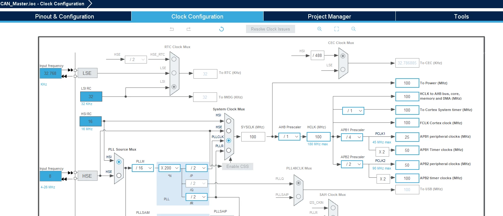

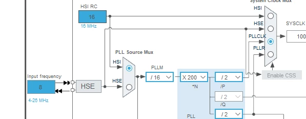

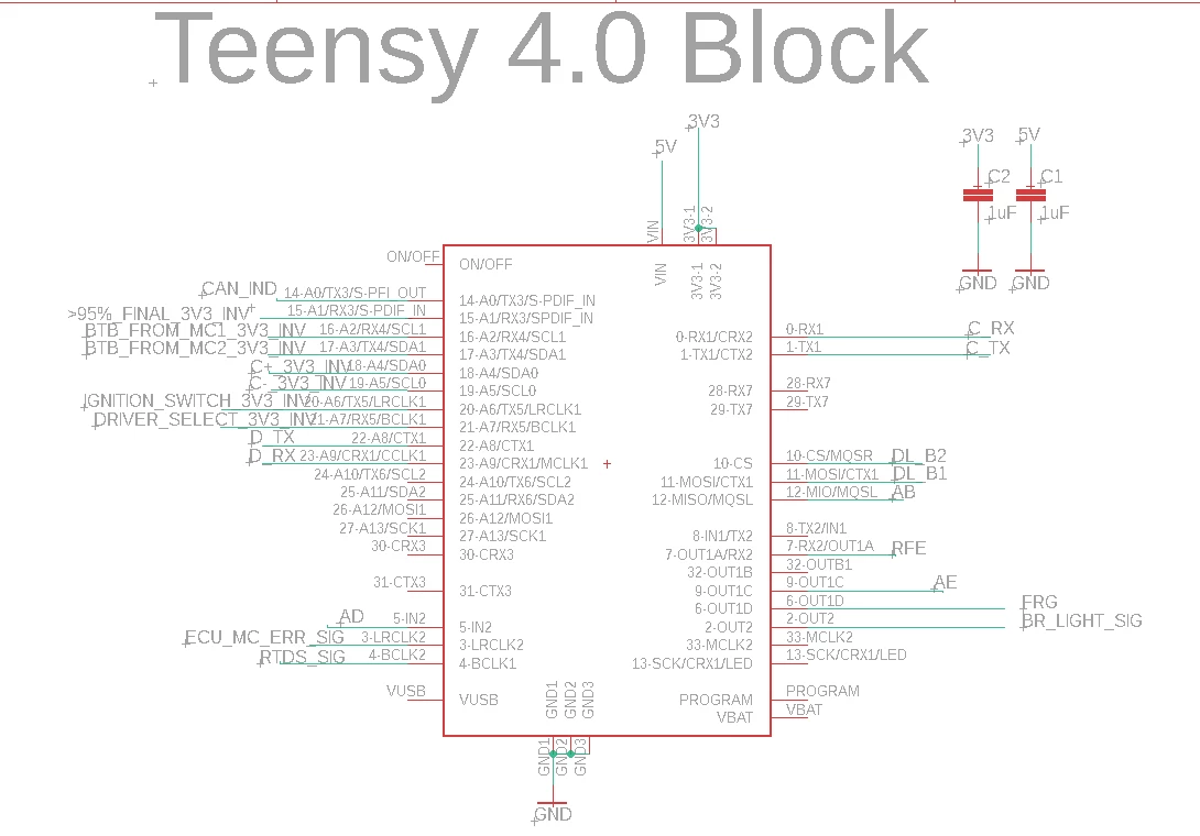

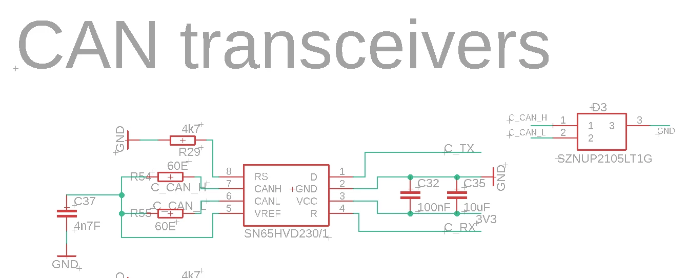

What's that "Teensy 4.0" dev board? does it contain a CAN transceiver?
Please post a sketch of your CAN bus with the two nodes: Nucleo F446RE + the transceiver +  Teensy 4.0 + its transceiver + the two 120 ohm terminating resistors as indicated in my previous post.
I need a clear view of your environment to help you efficiently.
+ It's not recommended to use HSI for the CAN communication in Normal mode. You need an accurate clock source such as a crystal.
What I suggest is to use the STLINK MCO output and configure the HSE in Bypass mode. I've attached the ioc file where I updated the RCC.

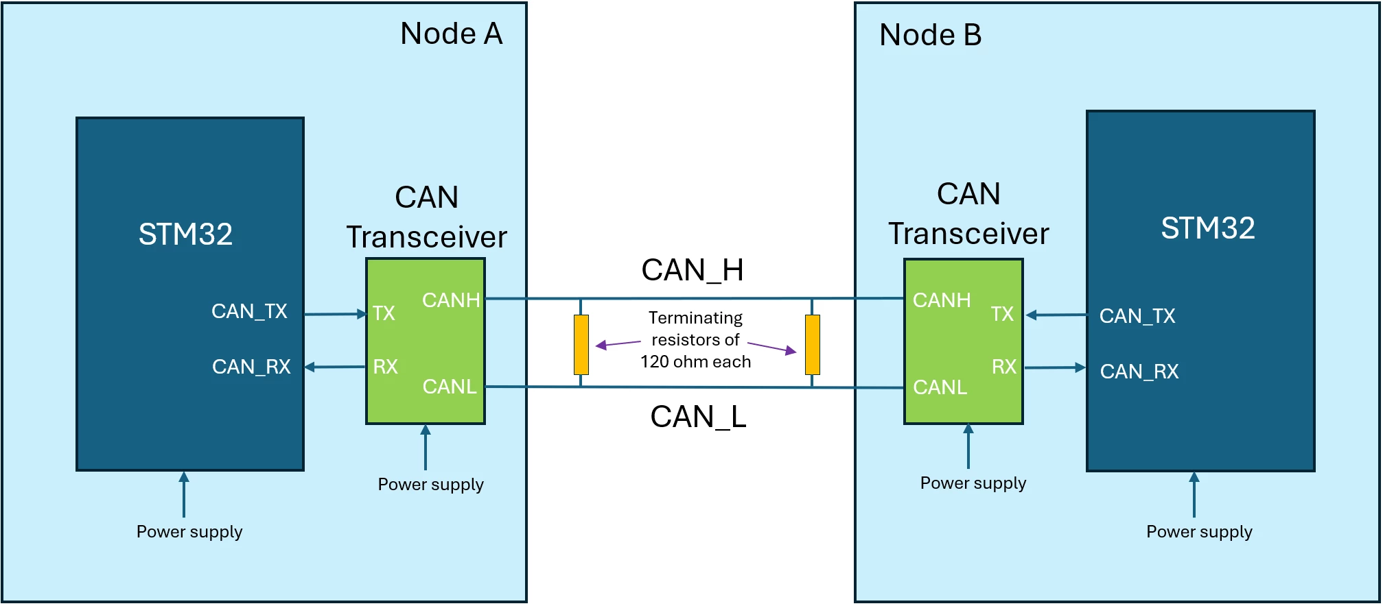

Hello @uti_prakash and welcome to the community,
First, please use </> button to paste your code. Please refer to this post: How to insert source code.I''m editing your post.
Second, as you are using Normal mode,
 hcan1.Init.Mode = CAN_MODE_NORMAL;
are you establishing a complete CAN bus as the following i.e. connecting a second node on the bus?
As per your comment, I suspect it's not the case:
 If not, that's not the correct way to use CAN in normal mode.
So either use a second node with the minimal hardware as shown above or use Loopback mode where you can use only one device. CAN is not SPI or UART.
If you are establishing a complete CAN bus please provide more details on the hardware used especially how you did establish a CAN bus.
For Loopback mode please read this article: Guide to CAN (bxCAN/CAN2.0) configuration in Loop back mode on STM32 MCUs
PS: better to attach your ioc file instead of sharing screenshots.
