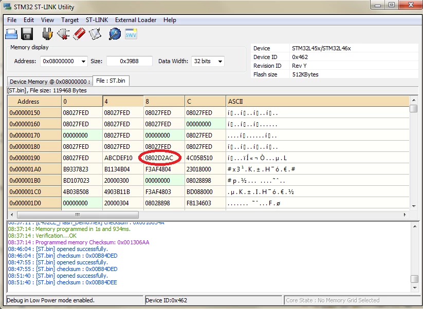

@Community member​  Here one problem is found. When my binary size is greater then 65KB it will not give me the proper size. In every case, when I am checking the binary size and read, it is giving me the first two byte is 0x0802 every time and last two bytes is size.
Attached snapshot of example, my binary size is 119468 bytes(0x1D2AC). When I am read from ST-LINK it is showing 0x0802D2AC.
Why it is added 0x0802 in every binary? Can you please provide me the solution for this?
