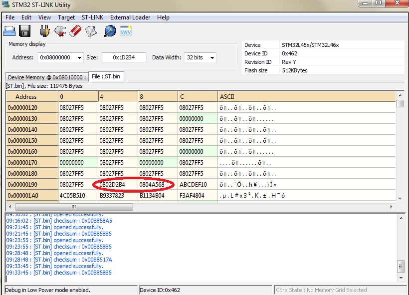

Generated binary file size in STM32L4
Is there any specific address location in generated binary file so we can know the size of that binary file?
Using this, in the firmware to read the size of binary file from that location and use it in our application.

@Community member​  Can you provide the feedback on this? We specify the "_limit_flash" as ".word" in startup file. So, Why it is store the 0x0802 (two bytes) every time in flash instead of storing the 4 bytes length of binary?

It is storing the end address, or limit, of the firmware image, for the length you'll clearly need to deference it from the base address of the image.
You can probably use existing symbols to do the math, the base of the vector table for instance.

@Community member​ I tried it with de referencing it. But not got the success. Please help me to do this. How it is end address storing? 0x0802 is not an address of any location.

All your other vector addresses are in the 0x08020000+ range, it is within the FLASH memory region.
/* End section */
 . = ALIGN(4);
 .endof :
 /* This is used by the startup in order to find the end */
 _limit_flash = .;   /* define a global symbol at the end of flash */
_flash_size = _limit_flash - g_pfnVectors; /* compute length based on beginning and ending points */
 } >FLASH

@Community member​  As per your given above solution, I added "_flash_size = _limit_flash - g_pfnVectors;" this specific line into linker file but still it is not working. Is it require to configure some other things which I have missed? What should require to do here?
Are you using the _flash_size symbol?
.endof 0x080086fc 0x0
 0x080086fc _limit_flash = .
 0x000086fc _flash_size = (_limit_flash - g_pfnVectors)
 .word	UsageFault_Handler
 .word	_flash_size /* symbol you define in .ld linker script */
 .word	0
 .word	0
Tesla DeLorean
Tesla DeLoreanBest answer
Guru
Jul 4, 2019 4:08 AM UTC
If that doesn't work try
 .word _limit_flash - g_pfnVectors /* compute size */

0690X000009YO8cQAG.png@Community member​ Yes, I have already used _flash_size symbol in the startup file.
.word I2C4_EV_IRQHandler
.word I2C4_ER_IRQHandler
.word _limit_flash /* symbol you define in .ld linker script */
In the linker file, symbol is used as per your suggestion. But not working.
