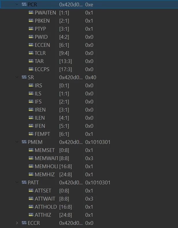

 FMC NAND SFRs in STM32IDE:

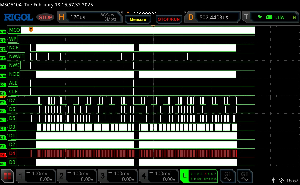

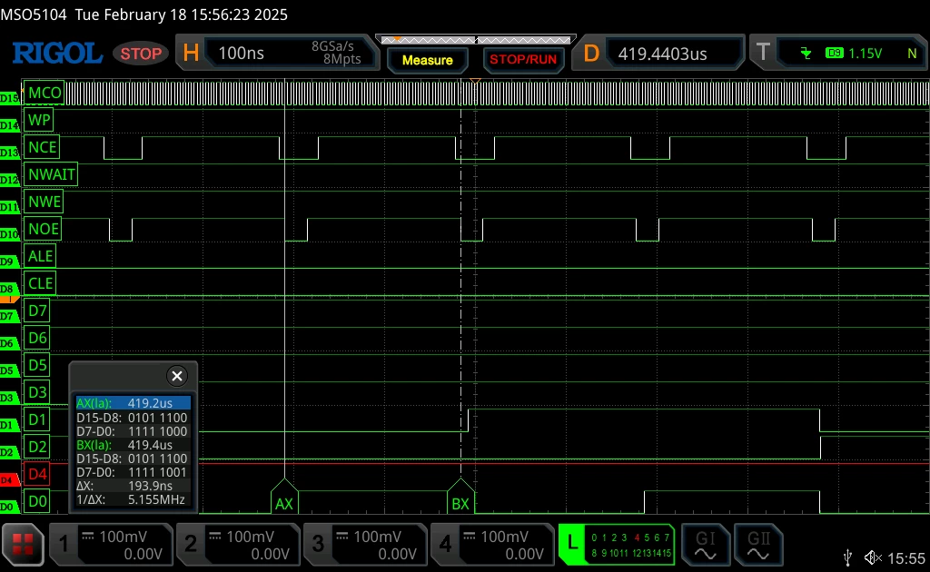

Logic Analyser on read transactions:
Logic Analyser display of 2 2k Page reads from NAND Flash chipLogic Analyser display of 2 2k Page reads from NAND Flash chipZoomed in NAND Flash read, showing 200 ns in between readsZoomed in NAND Flash read, showing 200 ns in between reads
