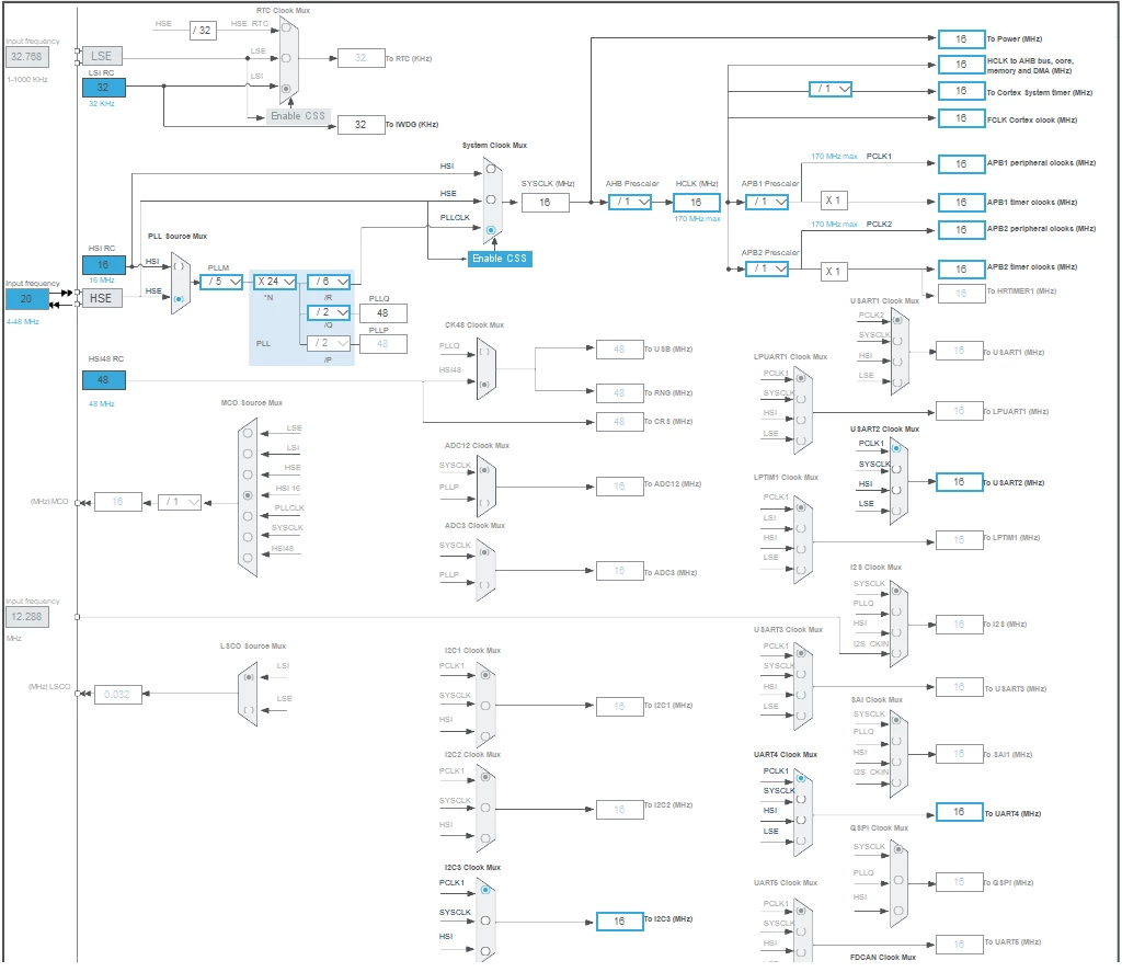

Unfortunately the post is too verbose and the log is not readable. But will try to provide some hints

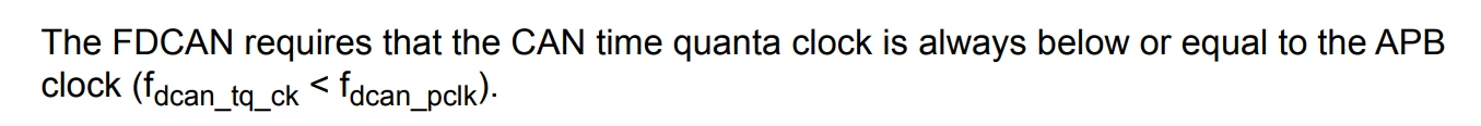

1- You didn’t show the FDCAN clock from the CubeMx screenshot. What FDCAN clock you have set? There is a constraint on the FDCAN clock setting. Please refer to this knowledge base article: FAQ: Fixing STM32 FDCAN communication disruptions - APB bus, kernel, and time quanta clocks
This is the constraint:
And from the reference manual: RM0440 Rev 9 /Page 1957:

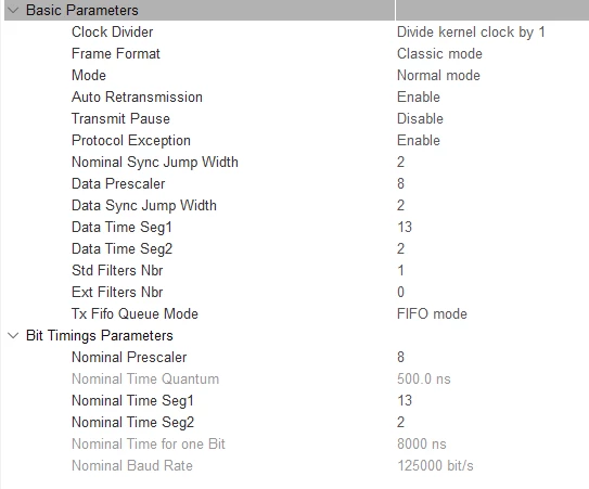

2- Otherwise, create a basic CAN example where nodes communicate together i.e. without CANOpen stack, activate all possible errors interrupts available and check if you face an issue/error. This will at least verify if you have a hardware issue or software issue.

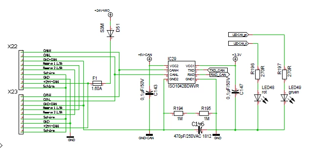

3- I don’t see an issue in the schematic you shared.

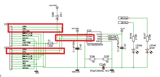

Forget to ask about the 2x terminating resistors of 120 ohm. I don’t see them in the schematic:
Did you put them directly on CAN the bus
Jul 8, 2026 10:13 AM UTC
We set up the bus with multiple electronic units via network cables of at least Category 5e and terminate the network using a 120-ohm resistor encapsulated within an RJ45 plug. X21 / X22 are the RJ45 sockets for Can IN/OUT
NMT Master (PLC, terminated) -------- -  X21 1st electronic unit X22 -------- X21 2nd electronic unit X22 -------- (...) ---------  X21 nth electronic unit X22  (terminator)

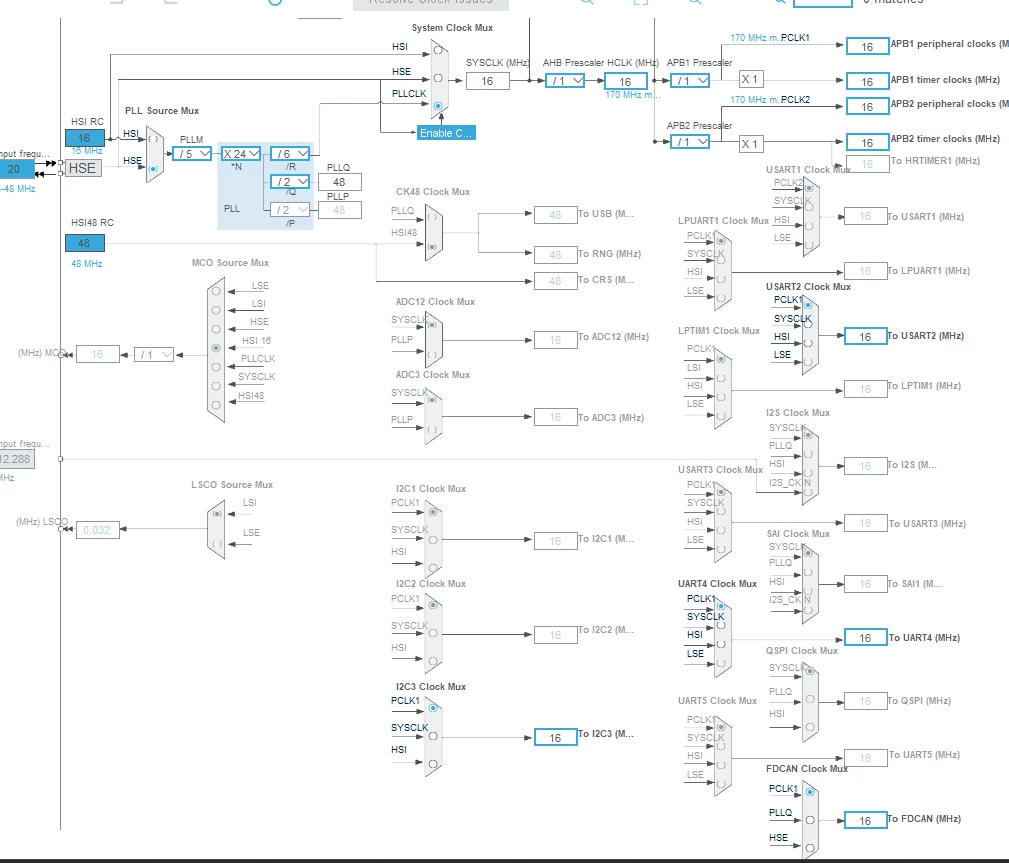

Jul 8, 2026 6:53 AM UTC
Thank you for your feedback.
 FDCAN is 16MHz as the others.
As regards the restriction on the FDCAN clock setting, it seems to me that even within ST there isn’t complete agreement on this:
The article clearly states: “The FDCAN requires that the CAN time quanta clock is always below the APB clock.” So it must be (fdcan_tq_ck < fdcan_pclk)
Mr Bowman32 says in the comment: “The FDCAN specification has been updated. The FDCAN requires that the CAN time quanta clock is always below or equal to the APB clock (fdcan_tq_ck ≤ fdcan_pclk). For reference, please see RM0517 Rev 1, section ‘Bit timing’.”
He refers to the Reference Manual for STM32H5E4/5F4 and STM32H5E5/5F5”
The STM32G491 Reference Manual RM0440 states: “The FDCAN requires that the CAN time quanta clock is always below or equal to the APB clock (fdcan_tq_ck < fdcan_pclk).
https://community.st.com/stm32-mcus-60/faq-fixing-stm32-fdcan-communication-disruptions-apb-bus-kernel-and-time-quanta-clocks-141123
All in all, this raises more questions than it answers.
mƎALLEm
Jul 8, 2026 7:24 AM UTC
I’ve already noticed that. I’ve already escalated that for investigation and fix (internal ticket for follow-up: CDM0064161).
But you didn’t state on my second point. Did you try to do a test with a very simple project? so you can validate the hardware?
Jul 8, 2026 11:37 AM UTC
The interesting question is: Which is correct? Can the FDCAN frequency be the same as the APB clock, or is it worth reducing it?
One more point regarding the documentation:
The STM32G491 Reference Manual RM0440 states: “The FDCAN requires that the CAN time quanta clock is always less than or equal to the APB clock (fdcan_tq_ck < fdcan_pclk).
This statement does not match the formula – it’s easy to overlook this!
