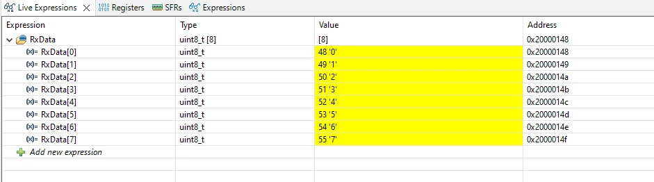

I double checked your Rx project and you didn't activate the Rx interrupt, that's why you can't see RxData in Live watch.
I also modified the filter configs. This is the live Expression on Rx side running on two G491 NUCLEO boards. As you can see, the data are updated continuously with the sent data from Tx project.
I'm attaching the reworked Rx project.

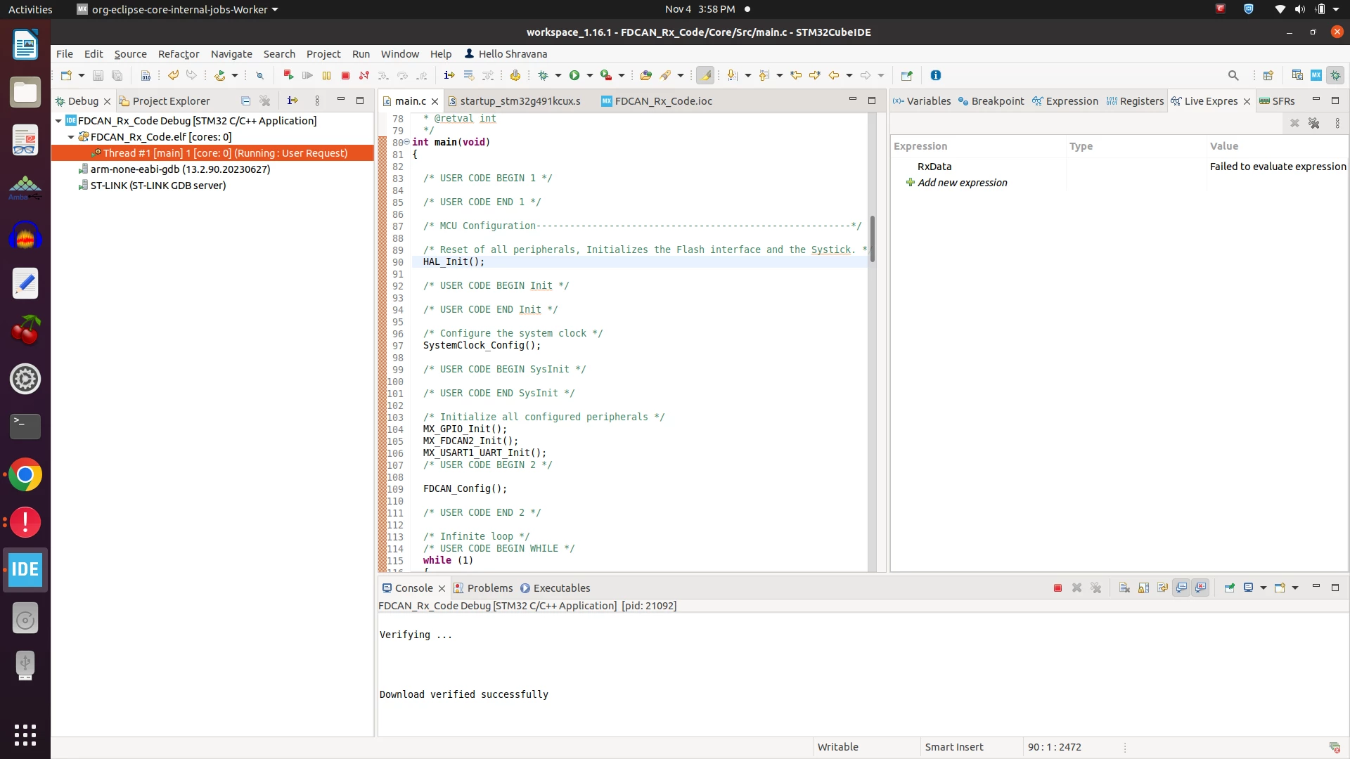

Let me explain the testing we did.
CASE 1:
Flashed MCU1 (Transmitter side) with FDCAN_Tx code. Booted the system and simply probed the Tx pin. Observed the data in Tx pin.
But the same activity was also there in Rx pin. Is this expected? There is no Rx activity related code in FDCAN_Tx code.
CASE 2:
Flashed MCU2 (Receiver side) with FDCAN_Rx code.
CASE 3:
Connected MCU1 and MCU2 for testing FDCAN Normal mode.
Powered the MCU2 first which is the receiver. MCU2 was booted up in Debug mode.
Powered the MCU1 which is the transmitter.
Then executed the application in Rx side (not in step by step mode, as per your suggestion). In the Live expressions, got an error for RxData side as shown below
Thus it seems like there is no data coming to the RxData buffer which is why it is throwing the error "failed to evaluate expression". Cannot understand why the callback function is not invoked in Rx side.
Is it related to the sample code we use?
Can you please guide us on this?
