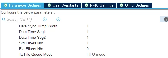

I am trying to make FDCAN work but I am not receiving any messages. The TX is working fine but when trying to receive messages the interrupt is not triggered. I am using STM32H7 series with freertos.
I have set the filter, started FDCAN, enabled interrupts, activated notifications,.. Any idea what I have missed?
Even when using external loopback, I can see the messages being sent but the interrupt is not triggering.
This is my code:

Thank you for your help. I have found the issue. I had filter definition but in the .ioc file my Std Filter Nbr was set to 0 since I forgot to set it. It works fine now!

mƎALLEm
August 19, 2024
First, why are you posting this thread in "TouchGFX and GUI" forum? need to be posted in "STM32 MCUs products" forum. --> will be moved then.
Second, why are you calling this in the FDCAN_Task():
 HAL_FDCAN_GetRxMessage(&hfdcan1, FDCAN_RX_FIFO0, &rxHeader, rxData);
and at the same time using FDCAN RX Callback where you are calling the same API HAL_FDCAN_GetRxMessage() ?
As you are using RTOS, I suggest first to make your example in baremetal before using an RTOS.
Also please read this article: https://community.st.com/t5/stm32-mcus/can-reception-issues-reasons-and-general-troubleshooting/ta-p/689741

since I am using TouchGFX i figured it seems appropriate.
I was calling it in the task and in the callback because I wanted to test it since it never gets to the callback because interrupt doesnt trigger. I have later removed it from the task and left it only in the callback.
Clock source selection: TIM6 with HSE crystal/ceramic resonator

Im trying to receive a standard ID 0x444 message.
Bus overload: Since I'm using freeRTOS and sending message TX every 1 ms , could that overload the bus so It wont be able to receive anything?
mƎALLEm
August 19, 2024
You need simply to increase the delay to get the answer.
But you need also to remove the call of:
from FDCAN_Task().
