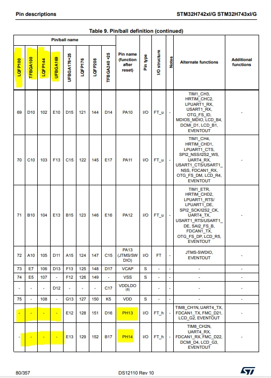

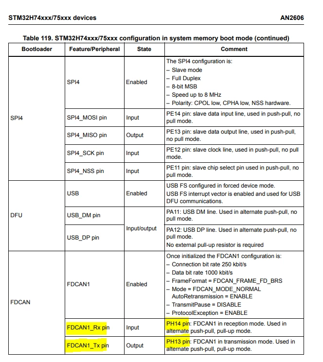

App note AN2606 says I should use FDCAN1_Rx pin PH14 (similary Tx pin) to be able to use FDCAN bootloader but selected package UFBGA169 doesn't have such pins.
Can I use default FDCAN Pins to work with bootloader?
