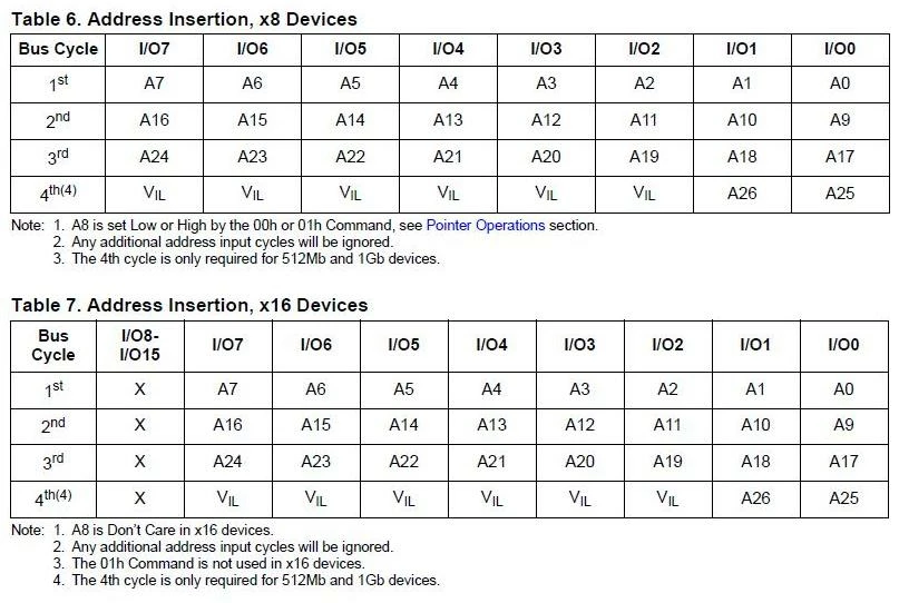

    what is the NAND Flash model or family ?
    Row and line addressing in Nand Flash are not always compatible between the ST Nand and the Atmel Nand.

    hello,
    you must check that the address insertion in the read_block/write_block functions of your Nand Flash software driver comply with the address insertion format in the table above.

    I am using STM3210E-EVAL . Nand memory is NAND512W3A2CN6 from ST.
    The same read_block/write_block functions are used by Mass_Storage Mode, when it is used with Computer. And the Mass_Storage mode can write to the NAND.
