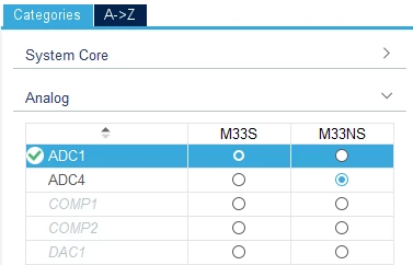

RomainR.
June 12, 2023
Hello JShah.7 (Community Member)
Change the Runtime context of your ADC1 in the STM32CubeMX configuration from M33S to M33NS.
_legacyfs_online_stmicro_images_0693W00000dDa62QAC.pngThen apply same ADC1 and GPDMA1 Parameters setting than my .ioc example, except for GPDMA1 Security, you need to configure a new Channel in Non Secure/Non Priviledged.
Then configure NVIC _NS to generate new GPDMA channel and ADC1 global interrupt.
Check also Security GTZC_S and GTZC_NS, ADC1 should be configured in Non secure mode.
Regards,
romain,
