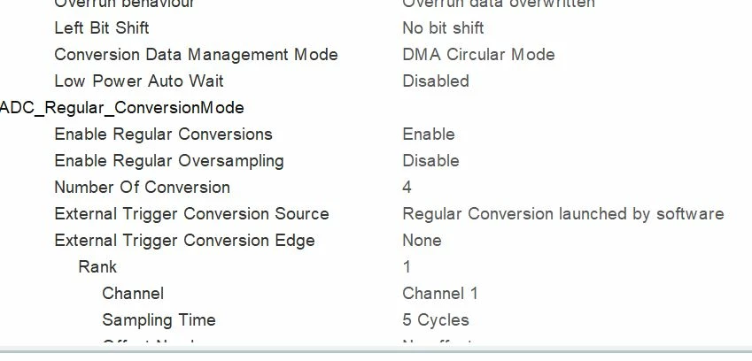

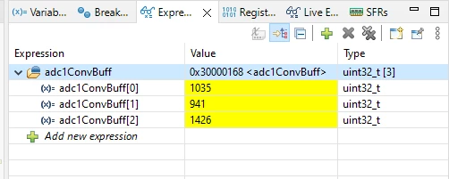

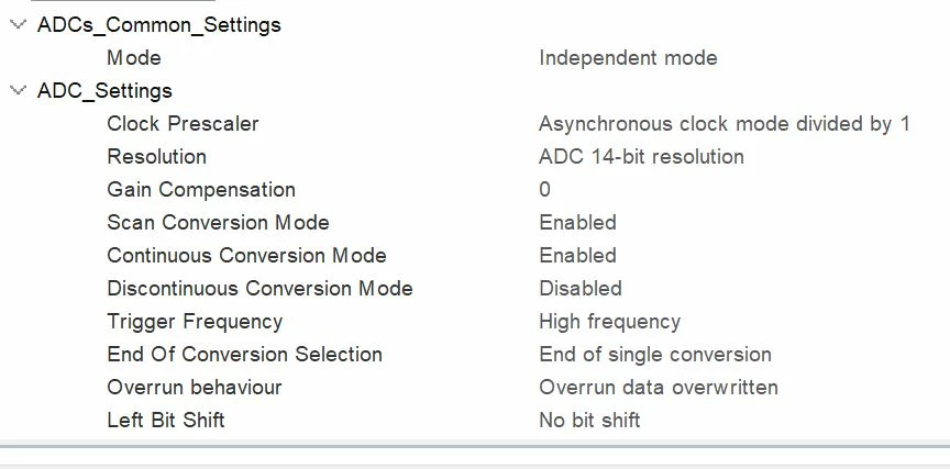

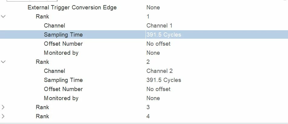

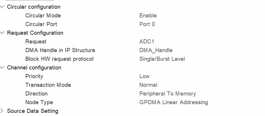

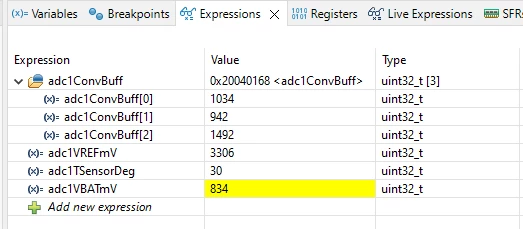

Here attached my previous project with ADC1 in non secure context (NS) and in 12bit resolution.
I also added ADC1 channel computation en mV for VREFINT, VBAT and Degree Celsius for TempSensor.
I do not implemented ADC4, it's up to you for its implementation where you want.

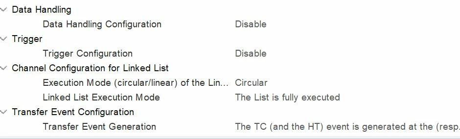

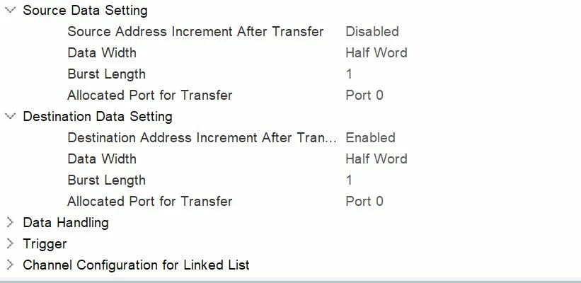

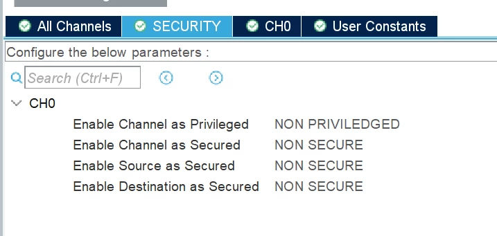

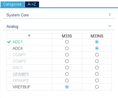

As explained before, I just changed ADC1 secure context as following.
- Regenerated the projet
- Move ADC1 user code and callback from \secure\main.c to \Nonsecure\main.c
Good luck.
